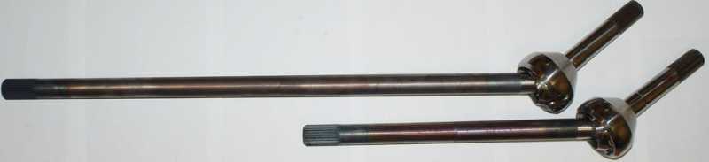

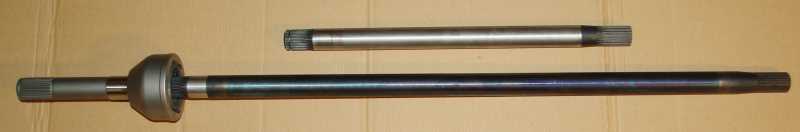

bluejimny wrote: the kits will be offered in 2 sets, one for the 22 spline and one with 26mm splines, if the customer wants to go down that route,
May I add my 5 cents? :)
Don't waste your time and money for making 22 spline shafts with TG cv-joints. It will absolutely pointless.
We make also two version enforced front half-shafts.
Version 1 is for stock 22 splined sidegears and stock SJ cv-joint.
Sometime half-shaft brakes at diff side. Sometime cv-joint blows up. If you use TG cv-joint I am pretty sure that failure will be at diff side always. Removing small piece of broken shaft from diff could be quite difficult and of course you need to take off diff from axle housing.
Version 2 is for 26 splined sidegears and TG cv-joints.
No issues with that type of shafts up to 35 simex tyres.
