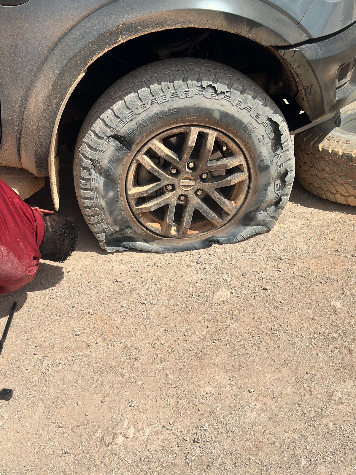

Here's the last flat tyre I had on the trail, no, this is not a Jimny, yes, I have been known to take two full sized spares depending on my destination, and yes, I have had multiple flats on the same trip and driven out on a tyre stuffed with grass.
