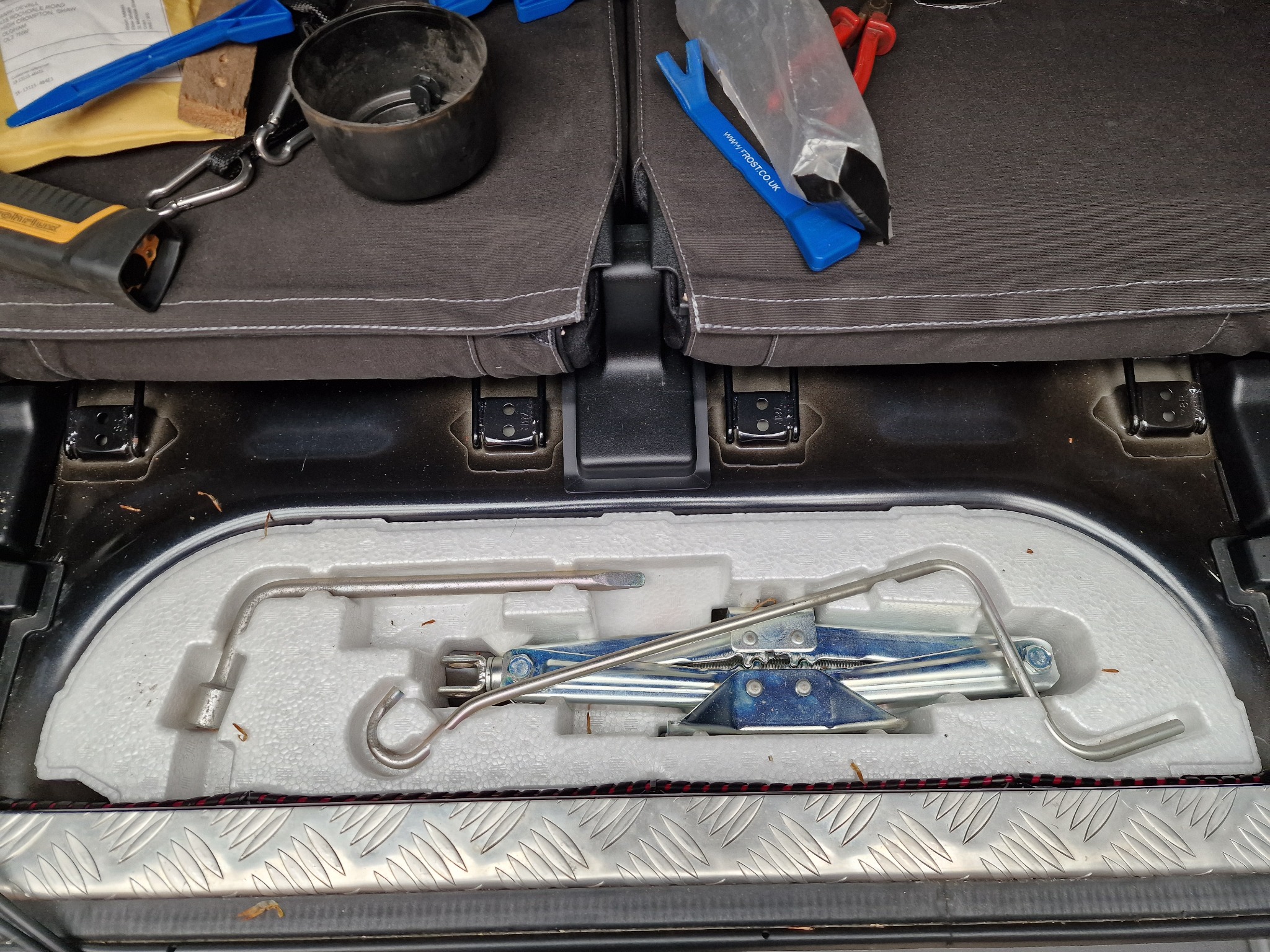

I was surprised when I was making the decking for Bellerophon that actually the base out of temeraire fit exactly?
So the time has come to discuss what I should do to regain some significant bump from the stereo?
The system as it stands is a Sony 4x100 class D head unit feeding a pair of 130mm yellow series kickers in the front supported by a 200mm active pioneer underseat sub. Having lost the rear deck and therefore the rear footwell enclosure running a further pair of 175mm yellow kickers it's now effectively missing a good chunk of mid range go. It was never a pa system but could be heard.
Now I seem to remember that the rear door cards are too close fitting to the shell to allow the use of rings to increase the available diameter of the rear factory positioning hence the enclosure in the foot wells. A set of 100mm would I guess help a little but size does matter in this instance. Oh and whoever designed the door cards to have the seats come out to get at the speaker location is a plank.
