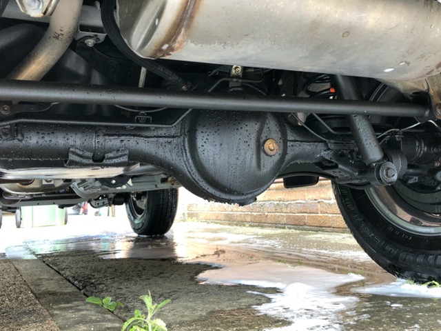

Really a week done job!
Leaning underneath the super Jimny I can notice some rusty points, especially on the end of the black arms of suspensions, making me thinking that it could be smart do the same treatment...
I will follow this discussion with attention...

Heck that's a job well done.
Perfect time to protect the underside when new, it should last a life time.
Your actions make sense to me, I personally have not seen anything that makes me think the G4 is any better protected than the outgoing G3 it replaced. Hopefully Suzuki have designed out some of the old rot traps, but it was lack of protection inside some of these box sections that was the G3 killer.
Once you have some wax in these sections you have it covered, well worth the effort and cost in my opinion.

Hi Looks great,
I'm about to do the same. How many cans of each do you think you'll need in all?
Thanks

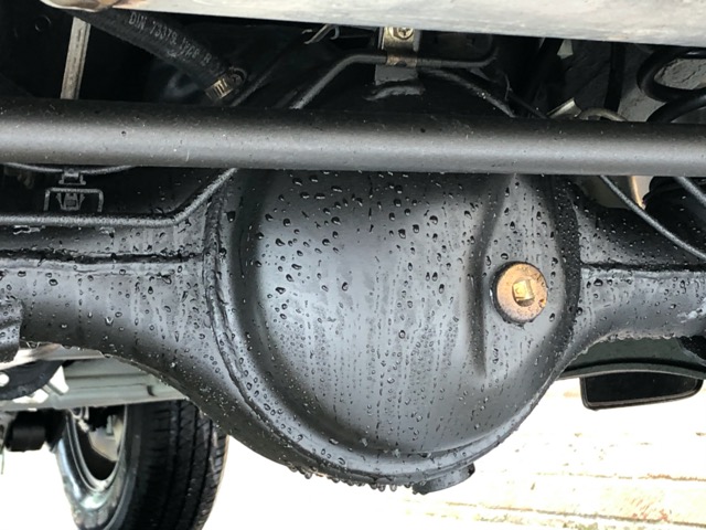

Hi Ynmij,
To achieve what's been photographed:
I used 1 x full tin of Buzzweld Chassis CIO. 1 x full tin of Bilt Hamber UB.
As you can see, I managed to get two good coats on the axle housings and running gear. But I've ordered another tin to complete the chassis & body mounts, along with 2 x tins of DYNAX S-50 (cavity wax) to protect inside the box section.
So to do a proper full underside job:
1 x Buzz weld
2 x Dynax UB
2 x Dynax S-50
All in cost about £100. Worth every penny as it'll keep mr rust away for a while. I'll probably keep a spare tin of UB in the garage for any future touch ups.
