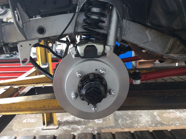

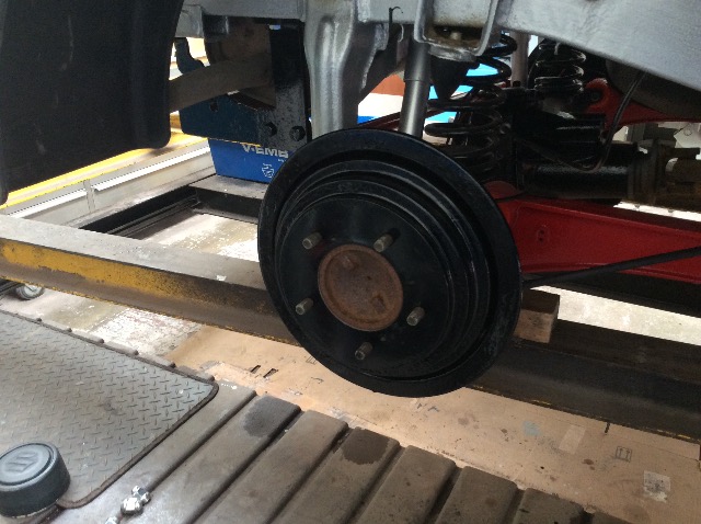

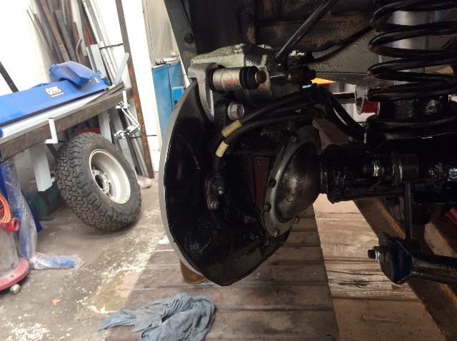

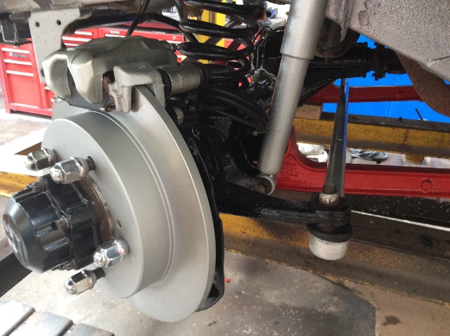

Hi guys
Just finished all the drive train off all new oils in gearboxes and diffs.
New rear shoes on the back brakes and full front axle rebuild, bearings seals and trimmed with new discs pads and callipers, not forgetting all new lines and good-ridge hoses just bled up nicely
And 4 new tyres just arrived
We’re flying today
Have a look
The doc
We’re flying today
Have a look
The doc

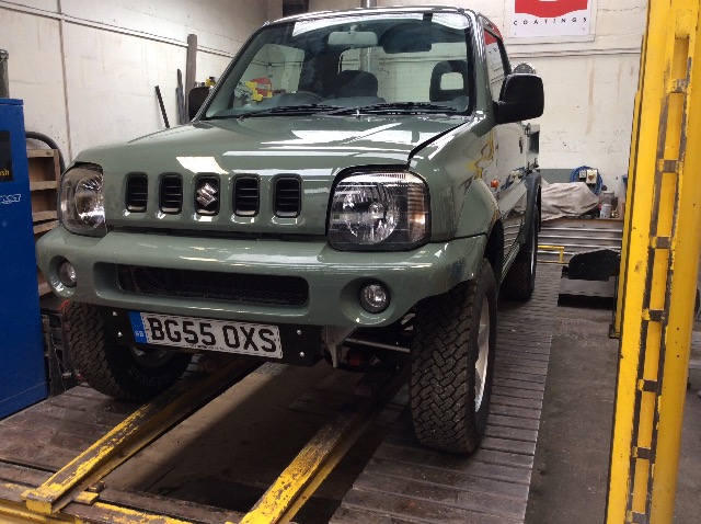

28 Apr 2020 19:00 #221618
by Jimny Dr
Replied by Jimny Dr on topic jimny pickup finaly getting finished
28 Apr 2020 19:56 #221620
Replied by Soeley on topic jimny pickup finaly getting finished
That must be the nearest thing you can get to buying a new vehicle, great job Dr and the Medics. Looks awesome.

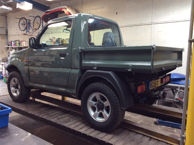

28 Apr 2020 21:19 #221623
by HUN
TrailMaster 2" lift kit
ORE transfer box HD brackets
T-Max split charge system
Flo-Flex castor polybushes
Kumho KL71 tyres
AVM manual hubs
ORA radius arm guards
Push-fit breathers
Replied by HUN on topic jimny pickup finaly getting finished
Only thing I would change is the floor of the flat bed. I would have used wooden boards instead of solid metal panel. Just to make quick access from above by taking the boards out. Timber is cheap and very easy to replace and they won't rust (just rot). That's just my preference of course. Well done guys!
Kumho KL71 tyres
AVM manual hubs
Push-fit breathers
28 Apr 2020 21:39 #221625
by Jimny Dr
Hi guys thanks for the comments they are very encouraging
I think the medic could soon be promoted to chief surgeon after his sterling effort on this one.
Regards the bed It’s been made to be removed with 4 nuts and bolts then it’s off, it leaves the rear light bar on so easy access for maintenance
Many thanks and be safe
The doc
The doc

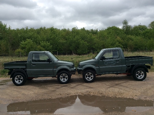

30 Apr 2020 09:52 #221683
by Jimny Dr

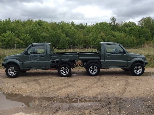

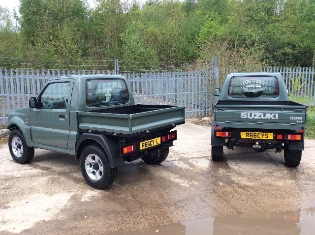

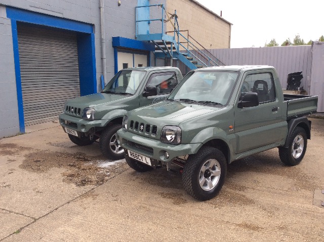

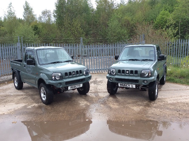

Here you go guys I have waited a long time to take these pictures and it’s a proud moment for me and Reece today
As the build thread says ( jimny pickup finally getting finished ) and now jimny pickup is FINALLY finished
Have a look guys and thanks for all the comments that’s been made as we have posted
Watch out for next project coming soon.
Take care guys
The doc
Take care guys
The doc
