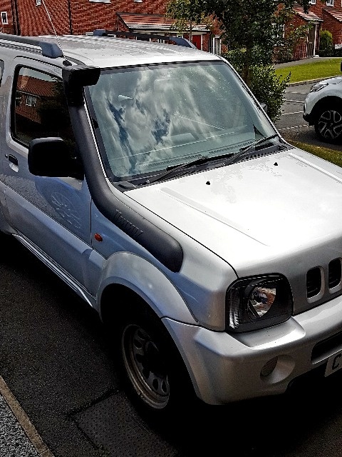

Picked it up looking like this...
First job was rear lights not working. It had a towbar fitted and the wiring had been hacked to bits. Pulled towbar off and basically remade rear light wiring loom. All working spot on now!

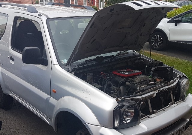

Stripped front and rear bumpers off, wheel arch liners out, spent a few hours pressure washing everywhere while the weather was nice, gave it a couple of days to dry out, cleaned all the metal up and painted. Chassis all got coated with underseal. It's all surprisingly solid. Some light surface rust but no major corrosion. Snorkel fitted while arch liners and air box were out.

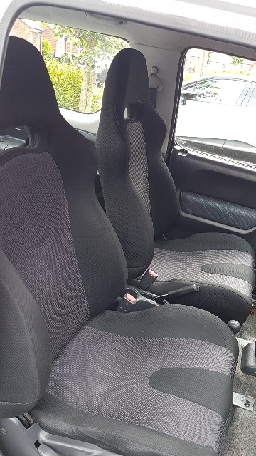

Fitted Subaru Impreza seats I picked up months ago and had waiting to use, have experienced Jimny seats before and knew they weren't for me. Rear seats being left out and will ply line the rear floor.

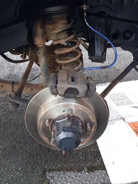

Brake pedal was nearly touching the floor and exhaust snapped just in front of cat. Picked up new exhaust and got that on (doesn't sound like a tractor any more). Fitted new discs and pads, will have a rear disc conversion at some point soon but stuck new rear shoes in for now and adjusted up. Fitted extended brake lines at the same time in preparation for a lift and bled everything through.

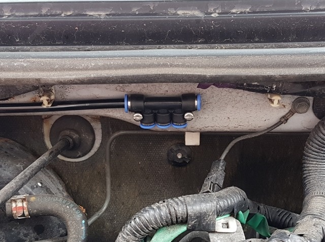

Started on extended breathers too. Manifold fixed with a couple of rivnuts, hose on left heads up the snorkel.

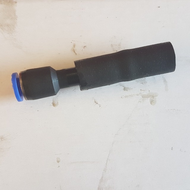

Diffs tapped and screwed in some 6mm push fit 1/8 BSP 90deg elbows (before I changed the oil, incase any swaft dropped in). Gearbox one nice and simple, pulled off the standard small rubber pipe...
In goes a 6mm push fit adapter
Then back on to gearbox with some 6mm hose into breather manifold

How did the Impreza seats fit? Alot of work?
12 Jul 2018 16:27 #194239
by ahtr
Not too bad, easier than expected. The frames are quite low on them which helped, bit of chopping and a few brackets made up with some 6mm flat bar and 50mm box. Was just a case of offering them up and see what worked.
