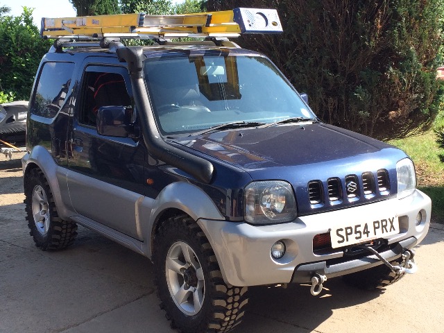

Nothing I'm writing here hasn't been done already no doubt by numerous others well before me. This isn't a "I'd have done this mate" or "You've done that wrong" thread, this is just my personal journey with my Jimny. I'm not looking for criticism, or praise.
I bought the Jimny after the usual "Worst winter in 60 years coming" newspaper article, we both had RWD BMW's and as much as I enjoyed sliding mine about the missus didn't. She needed a car then to get her back and forward to work and her car was perfect for that most of the year, so I bought the Jimny as a backup to ensure she could get about in the worst of weathers.

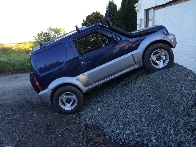

It wasn't long before I found video's of them on youtube, and actually stumbled upon this very site that gave me the bug to start modifying the little hardtop. First with the fitting of a winch & recovery points, some transfer and fuel tank guards and a snorkel. I also made Van panels out of fibreglass by copying the windows and making moulds, then making the part in fibreglass and having a mate paint them and bond them in.
It never seen much more than a muddy lane at that point, with a farmer friend letting her have a drive about on his land to get herself familiar with the 4wd system and to feel what it was like when sliding around on loose terrain. It make the jump to start my own business and ordered a factory build van to my spec, unfortunately the van took longer to get to me than was agreed with FORD so I decided to use the Jimny for a short while until my van arrived. Back seats pulled out and a plywood floor & half bulkhead created and away I went. Not the most professional looking but it served it's purpose.
During this time any mods or even thoughts of them were set aside, I needed this vehicle to earn a living. When the van finally arrived then the Jimny was fair game. To begin with it just pretty much lay about and got in my way, I was flat out with the business and didn't have time to tinker let alone play. I even thought of selling it (glad now I never).... Slowly I started building up parts, secondhand cranked arms, 3 inch lift kit, newly built Rock lobster from Rockwatt, new panhards, brake lines etc... But with not having any time to do anything it just lay in my garage gathering dust along with the Jimny. Hearing about an event in a local quarry I made some time off and took it as was
She drove it most of the day and loved it, it gave me the push to get it built for her. Shortly after I started fitting what was lying around, giving it the lift first then getting it out at drumclog for a day.

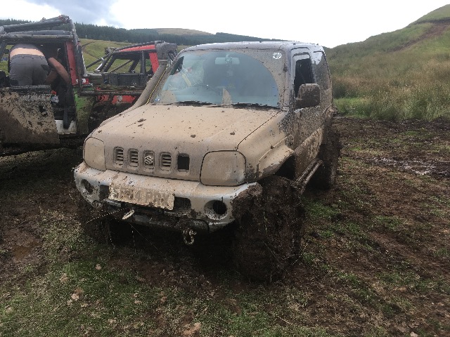

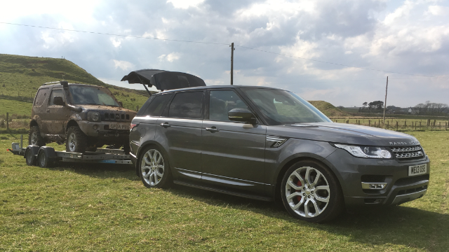

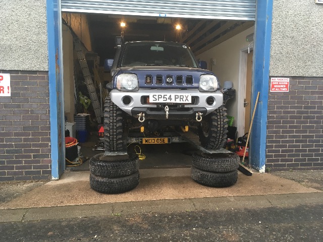

With not too bad of a day at Drumclog the one thing bothering me was that it got beached a lot, the standard insa turbos weren't giving me enough clearance and if cross axled at all we lost drive. Was time for a push to get it more capable, Rock Lobster got fitted along with a lock right locker in the rear diff, axle's got trussed up at the same time as the truss kit had been lying about for nearly 2 years. Next time out it done much better but we still needed taller tyres, so I fitted 31x10.5x15 Insa Turbo special tracks, same tyre I had previously but just a bigger size. The 31's and my spacers meant some bodywork and the grinder came out and some LR 4x4 arches were fitted.

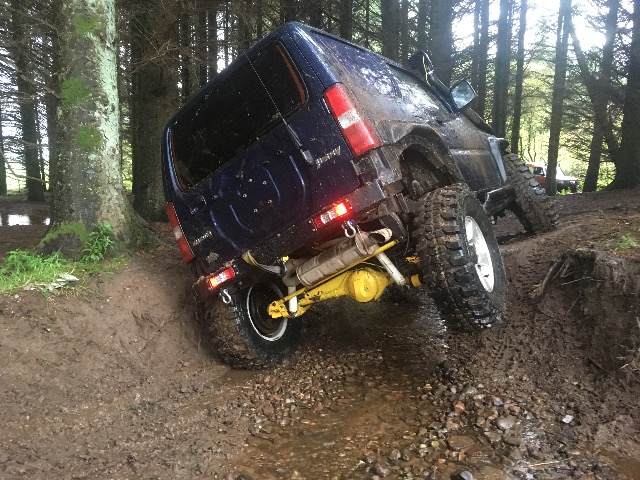

During a heavy rear recovery the need for a decent rear bumper was found along with just how soft the standard tow points are so a bumper was made to my spec by Scott McMinn of SMM, over the moon with it to be honest. I gave him the led light units I wanted to use and he pocketed them into the bumper with built in guards.

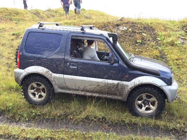

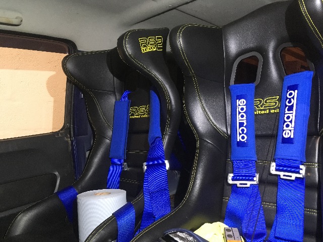

We got the Jimny back out and found it much more capable at Drumclog, all the mods were starting to pay off, although we almost smashed our heads together numerous times on the rough terrain so I decided that some decent seats were in order... Cue the Mirco RS2's from GSM Performance.
These seats are vinyl and easy to clean, they're also very comfortable and give us both plenty of support. They also reduce the travel on your head when the terrain gets too rough and teamed up with some harnesses it makes all the difference.

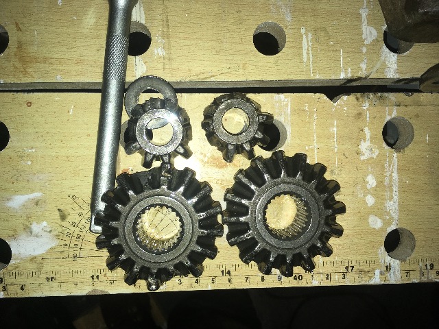

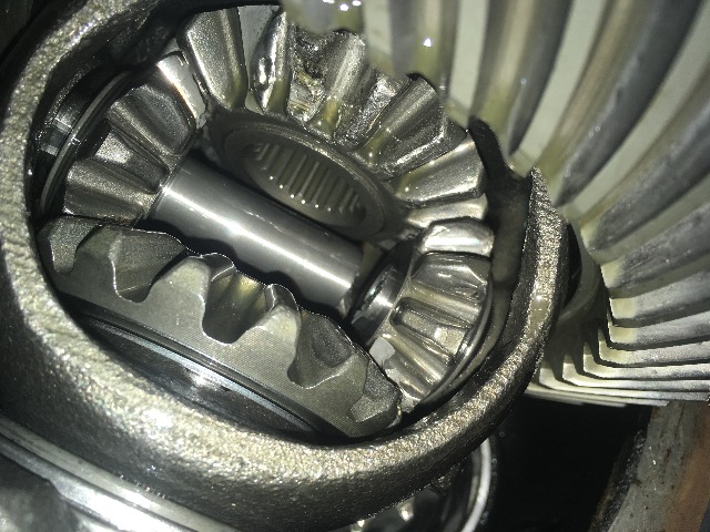

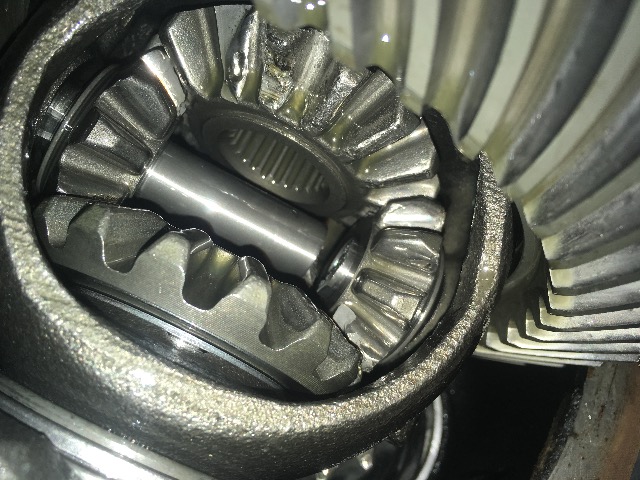

Currently the Jimny is lying on the trailer with the front end in bits, blown diff. My own fault to be honest, although the front diff never quite felt right so possibly some of that damage was before me. I have a Kaiser diff sitting waiting to go in the front, hopefully I'll get to that soon. Thats the evolution of my jimmy so far, I'll add some more pictures below.
