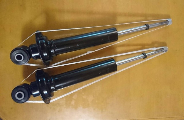

the front strut on the sj80 is completely different to gen 3 jimnys (look up kyb shocks), but the rear setup is a simple shock and coil which you could figure out how to change from any specialist quite easily i'd say. the picture is a front shock, where the spring sits on the bottom plate and then sits inside the cup on the body. only thing i was unsure of was the weight of the engine in an sj80 and spring rates.
