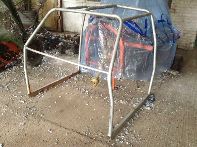

have been building a roll cage for the jimny the last few weekends whats everyone think? B)

yeah this one's an internal cage

It looks chunky but needs some triangulation! What size tube are you using?

yeah got a few more bits to add to it not quite finished yet , but its 60mm :unsure: the company i ordered from messed up the order and got sent bigger tube than i wanted, just thought ah well see if i can make it work
