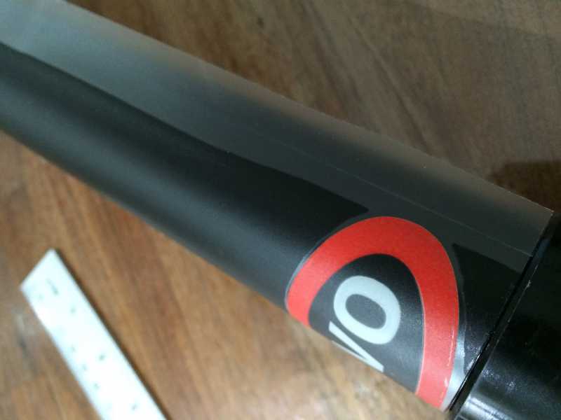

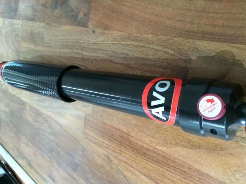

Slow delayed start seen as I was meant to be cracking on, so spent a token gesture 30 mins wrapping the shock absorbers so they are not rusting/corroding away by next winter, the durability of the finish isn't the best on these which is a shame as the quality and performance is very very good.

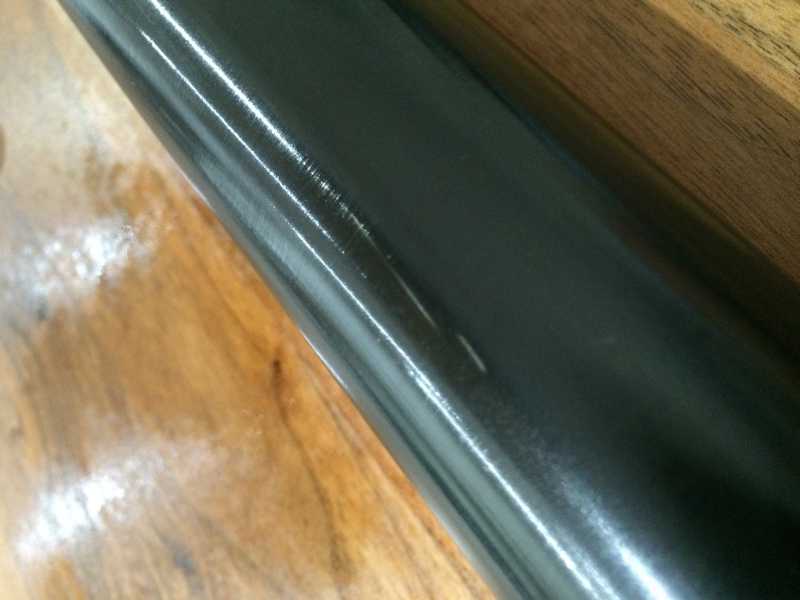

already though the paint to bare metal from scuffs and "light" paint coverage, a few more coats and a lacquer coat at he factory and these would have a chance of surviving.

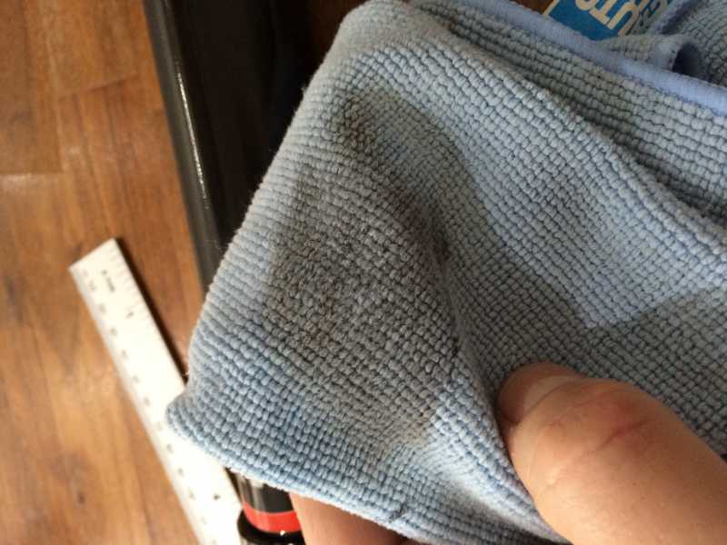

That's paint on the cloth not dirt ( cloth did have IPA on it but still!) !! Wrapped with 200-220 micron "Rhino Hide" (same as 3M heli tape but can be removed much easier and is a dream to apply in comparison) which can be peeled off as and when, but will stop the springs and panhard along with stones rubbing though.
Not quite finished wrapping all the way around, was easier to have a 11mm over lap than try and trim the tape down to 139mm and hope they met square
