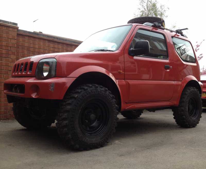

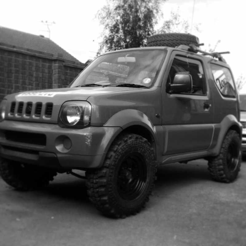

  • Lukeavb
20 Apr 2014 17:05 #112769 by Lukeavb
Replied by Lukeavb on topic New jimny build thread
Quick cheeky snap shot of the jimny, got all arches trimmed after I took this picture.
  • 2014Nathan
21 Apr 2014 19:17 #112903 by 2014Nathan
Replied by 2014Nathan on topic New jimny build thread
nice bud, what did you have to trim in the end as in where abouts in the arch?
  • Lukeavb
22 Apr 2014 06:58 #112945 by Lukeavb
Measured 50mm all the around the arches to cut off and then used the jigsaw on them, took 60mm from the actual metal arch which is behind, all smoothed off and painted after, will be looking at some kind of mud guards or rubber matting to go inside the arch to protect mud from spraying up.
