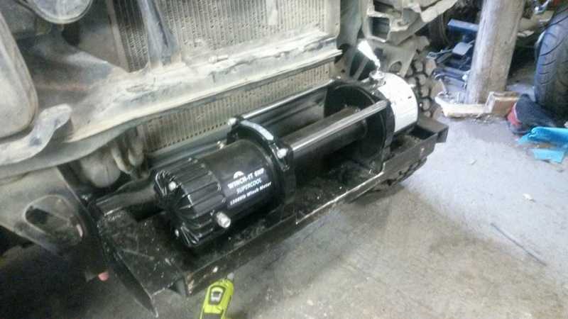

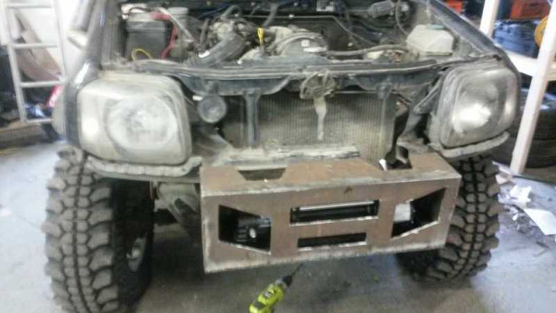

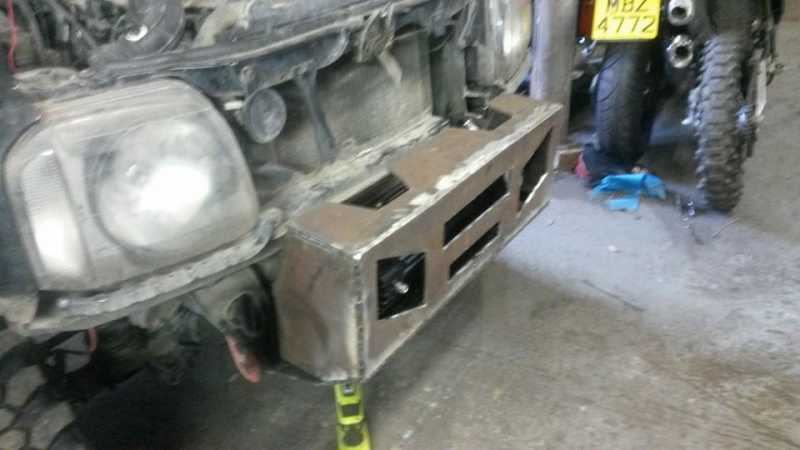

received the winch today and got it fitted its quite a lump toke to solinoid of the top is this recomended i was going to stuck it up by the battery to keep the water and mud away would be a lot easyer to leave on top the winch as new wires dont have to be made
cut some holes in front and top for access etc
now to clean it all up get the sides made then nearly all done

Performance wise it's best to place the solenoid as close to the winchmotor as possible.
If it's an Albright solenoid it's waterproof.

thats good news about solinoid its going back ontop then it is a allbright the company say to put it as high as possible but thats just them covering there back i suppose picking up some 2mm sheet tomarrow for free grinding disks were free paint was free so allits cost so far was £350 for winch and £12 for some box section i do love it when a plan comes together
