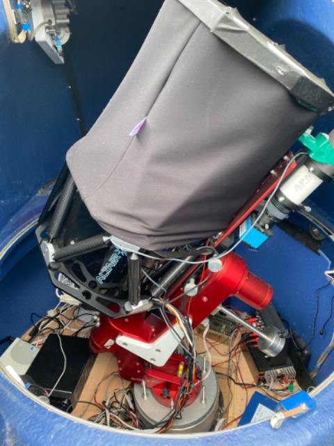

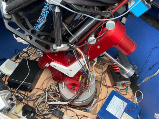

24 Apr 2023 09:09 - 24 Apr 2023 09:47 #248812
Replied by DrRobin on topic Re:Home made Astro Sky Cam
My mount is the same basic design as Martin's, except rather than it been a classic equatorial mount where the scope hangs off one side with a large counterweight, it is a signle fork design. This allows the scope to sit close to the main axis and reduces the counterweight size to almost nothing. Not only does this provide for higher performance (less mass to move), it also makes it very compact and that was what I needed to fit the 10" scope in a small fibreglass dome. Unfortunately there is only one manufacture of this type of mount and I think they machine it out of a solid block of gold, they cost a fortune.
The mount (in red at the bottom) is supported by a home made pier, about 160Kg of concrete, SS reinforcement rods and a home made aluminium pier top to hold the mount. It's very stable and isolated from the rest of the dome by earth and rubber gaskets.
The scope is a 10" carbon fibre truss tube design, they cool down very quickly and are also very stable. The scope is optimised for photography, it gives a large flat field with very little distortion even across a 35mm camera.
The guide scope and guide camera are the white tube and blue box under the main scope at the top right.
Robin
Robin
