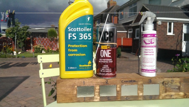

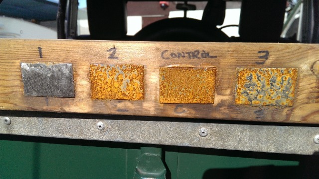

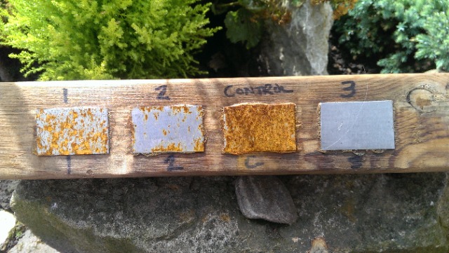

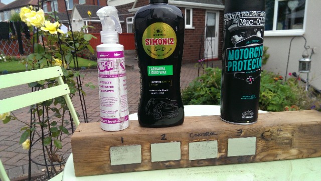

It's been a little slow this year with lockdown etc, so to alleviate the boredom I decided to do some product tests on claimed Motorcycle / Bike protection films.
If you have a motorbike / cycle this may be of interest. The following products are commonly used by motorcyclist to keep corrosion at bay on their pride and joy, but which actually work?
To decide I conducted a round of corrosion tests on mild steel plates, each treated with the product and left for 7 days, salt spray each day. One sheet left untreated as a control. The winner of test 1 was tested again in test 2, just to be sure.
PRODUCTS:-
ACF-50
Car wax
XCP ONE
Scottoiler FS 365
Muc Off Motorcycle Protector
Test 1
Result
Test 2
Result
And the winner is ACF-50. Which is what I used..... Also tested Mr Sheen and WD40, they appeared no better than nothing.
