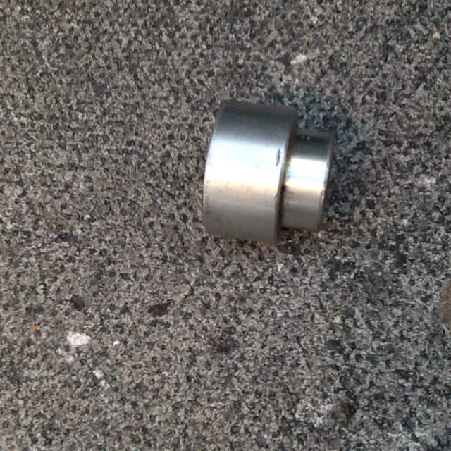

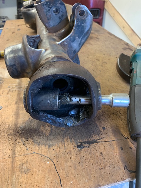

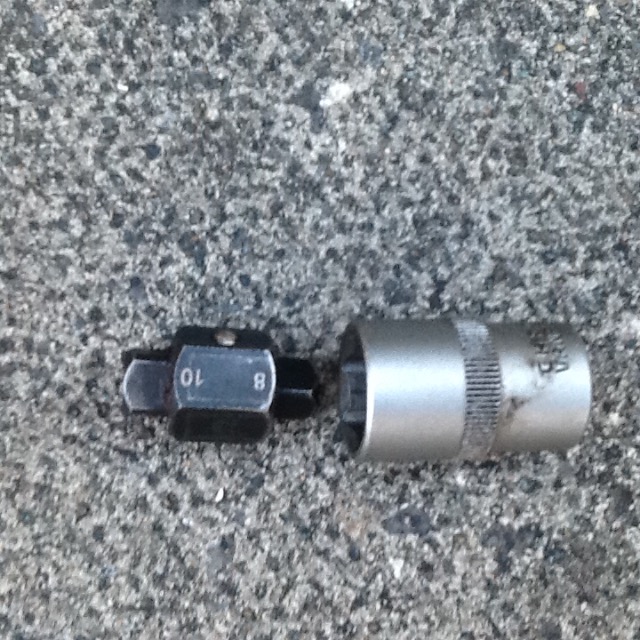

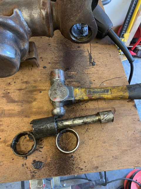

Thought I'd share a few useful tools I have acquired.

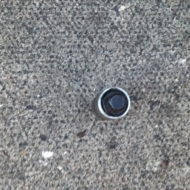

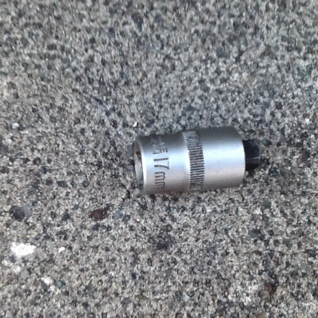

first is the "proper " tool for the gearbox , transfer box, diff so drain and level plugs . 17mm socket with square attachments . So can be impacted if needed to loosen ( carefully) and no rounded plugs ...

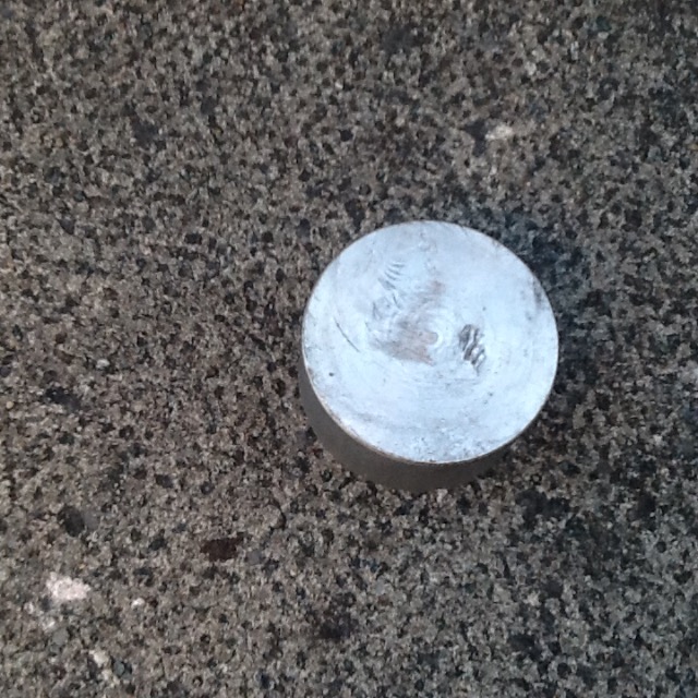

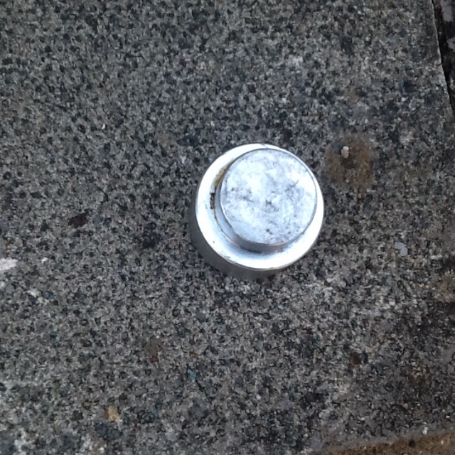

next is something I had made up . A drift to fit / remove kingpin bearings ..outer size is race size to seat ..inner taps it out . ( made for a motorcycle fork seal but diameter care the same. ) So no damage to bearing or socket set!
I have a spare should someone wish to copy .image.jpeg[/attachment]
Last edit: 06 Mar 2022 19:38 by Fossie. Reason: repated

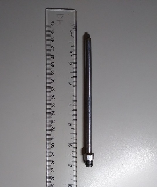

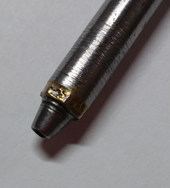

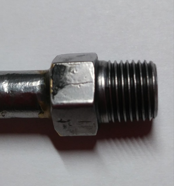

From experience gained with my LC, I realised that greasing the pins on the back door hinges is a good idea, so I checked on my Gen.4 and found that Suzuki had drilled but not tapped a suitable hole in the hinge, so I made an adaptor to pump in some grease.
You can just use a modified grease nipple placed into the jaw of a grease gun but it wobbles a bit and extra care is needed so I brazed the nipple into a 150mm long tube with a threaded adaptor at the other end. The nipple needs the threaded section machining to give a tapered section to locate into the hole in the hinge and this is best done on a lathe. I brazed it all together but soldering will probably work as the pressure is quite low.
Roger
