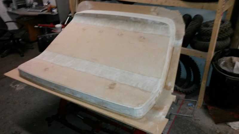

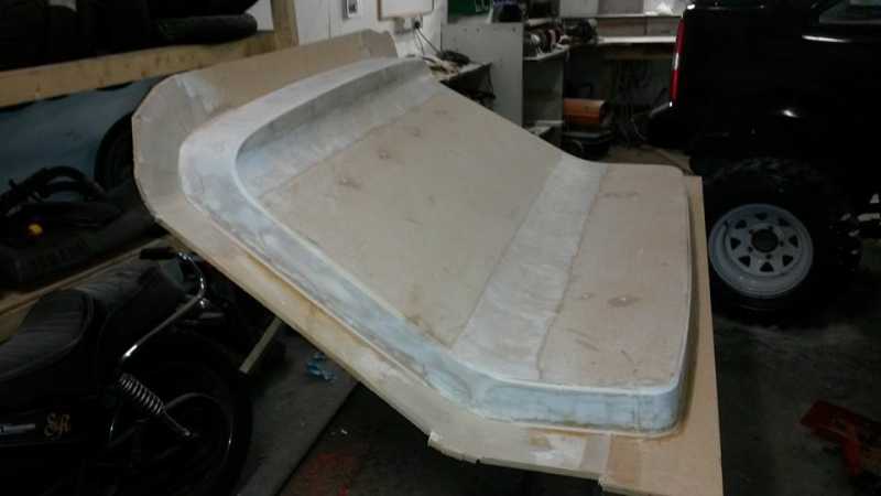

cheers mate couple more pics from today didn't get much done though for the time it toke tomorrow ill get some more done and hopefully get the mould off it the weekend

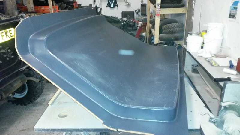

got the plug durabond premiered (all 12 coats) now needs the long process of wet flatting filling any lows then more primer then down through the grades from 240 to 2000 grit then a polish then the mould can be take of this
I think at this stage give a good idea of what its going to look like
I wish I didn't have to be so precise about things would take half the time
