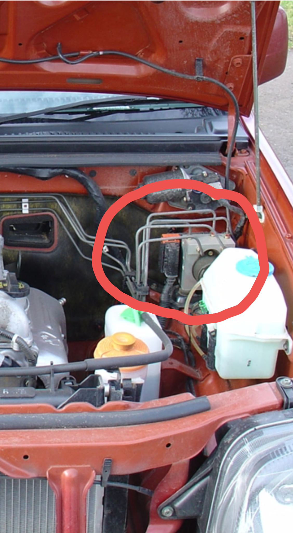

Do an emergency stop on a wet road and you'll soon learn if you have abs or not. Or look under the bonnet for an ABS pump like this. If there's just fresh air in that spot it's non-ABS.
The other variable for pre-2005 cars is whether it has an automatic or manual transmission. This determines the differential ratio.
So what you need will be non-VVT, (auto or manual) (ABS or Non-ABS) axle.
