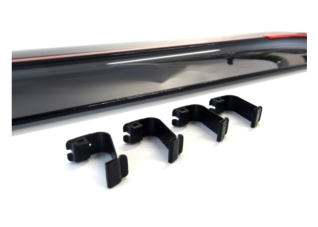

12 Oct 2024 01:23 - 12 Oct 2024 01:24 #257855
by atxzizou
Replied by atxzizou on topic 2025 Jimny Wind Deflector Mounting Clips
Last edit: 12 Oct 2024 01:24 by atxzizou.
12 Oct 2024 01:50 #257856
by fordem
Replied by fordem on topic 2025 Jimny Wind Deflector Mounting Clips
The newer deflectors come with those clips, the older ones didn't - strictly speaking they are not necessary in that the deflectors can be installed without them - my 2024 has them, my 2021 doesn't.
My 2024 Jimny is the only vehicle I have owned that has had these clips and I have installed deflectors "without clips" on half-a-dozen other vehicles and not had an issue.
Follow the instructions and peel back the last inch or so of the protective film, position the deflector where you want it and then whilst holding it in place, pull the film out and simultaneously press the deflector into place.
12 Oct 2024 02:11 #257857
by atxzizou
Great! Thanks for your reply.
I’ve also owned other vehicles without these clips, they were either glued on or installed in the window sill.
I thought about installing without, I honestly can’t seem to find a reason why they have clips in the first place. Maybe as a backup in case the tape fails?
I will do one last thorough search for the clips, otherwise I’ll give it a shot.
