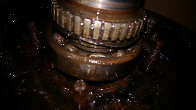

Hi, I have removed the rear axle oil seal (bearing given up!) but there was no oil seal protector? So, do I actually need one, and if so, where can I get one from. Shop on here says out of stock and I can't seem to find one on ebay? Thanks.

Good morning me101. Your picture shows the bearing and the bearing locator ring. The oil seal and protector are located inboard of these items. As Suzuki have included the protector I suggest you contact a dealer direct as the cost is peanuts in comparison to the bearing and it's lock ring..

Hi, didn't have a pic of the seal area, just the bearing that caused the problem in the first place. To be honest, the main stealer didn't even cross my mind! Have now ordered one from them, only about £6. Cheers
