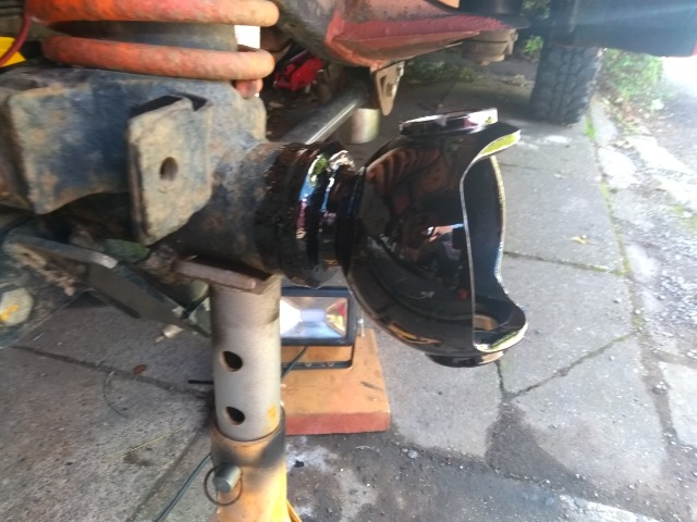

If you have the time and patience
You can paint the swivels with POR15
I gave mine 4 coats with a little rub down after each coat

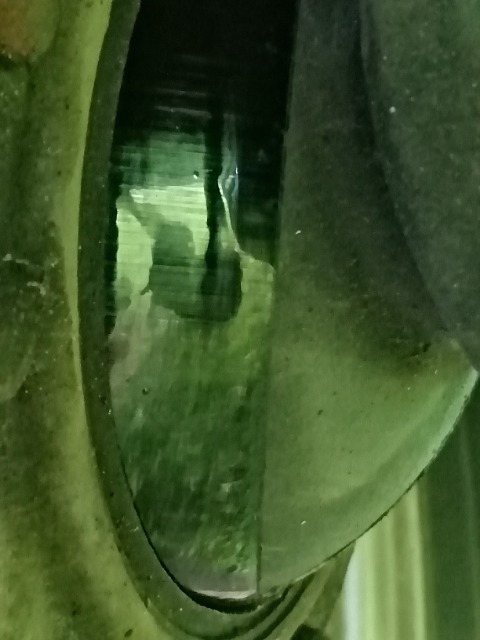

Hi Busta,
I dont doubt that someone had issues with gaps, but it suggests something else was wrong with that one.
My seals stay in contact lock to lock, you can see this in the photo as the dirt wipe line is complete without gaps, it's working like a windscreen wiper, cleaning the wiped area, dirty on the none wiped. I can't see any dirt or marks in the wiped area, all shiny black paint.
Only time will tell if my refurbished swivel make things last long, it's why I did it as a long term test. It's approaching 2 years without issue, but not taking it apart until it fails again, so I can't confirm what's going on inside.
Totally agree you are wasting your money changing the seals if you have rusty swivels, you may as well leave them off.

09 Jul 2021 09:33 #236546
by Busta
Replied by Busta on topic Wanted: Kingpin Bearing Kit
It's at the very top and bottom where they showed the seal comes away from the swivel. Yours looks good. Hope it does the trick!
