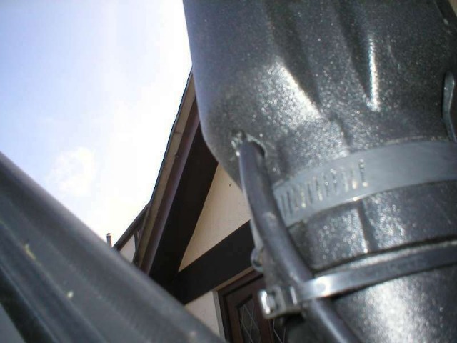

The best place is always the highest point possible, in the snorkel head if possible.
On a previous installation...
The breather tube goes up and into the head, protected from the rain, so it would just be matter of popping the tube through the head and stick the breather filter port on the end of the breather tube and then pop the snorkel head back on...
Or take the grill off the front of the head and reach in... but don't drop it!!! :ohmy:
