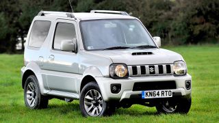

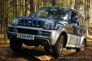

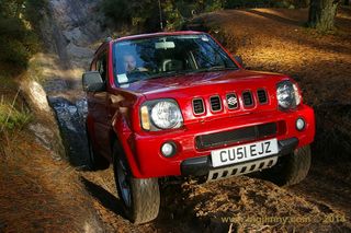

Applicable vehicle models
Just to clear up any confusion, below are the pictures of vehicle models which this article refers to.
Jimny 3
- Jimny 3
Jimny 4
- Jimny 4
