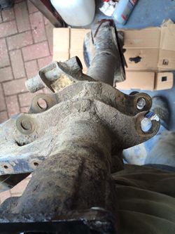

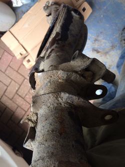

Damaged Mounts
Worn Axle Mount
The mounting points for the arms are really weak and thin. They can wear out in an "oval" fashion that results in a strange "clunk" noise when letting the clutch up. In the worst case the mount can corrode through and rip away from the axle, this is becoming increasingly common as Jimnys get older.
Oval Axle Mount
Here is a picture from Dave over at Bits4vits showing the wear in his mounts. It is worth checking every now and then by undoing the bolts and taking a look at whether wear is occurring.
Good Axle Mount
For reference, this is what a mount should look like!
Broken Axle Mount
This is the same part as shown in the previous pictures except it is completely ripped off and gone!
Broken Axle Mount
Again from Dave, his destroyed axle mounting brackets.
Further information on repairing the mounts can be found in Axle mount repairs section.
