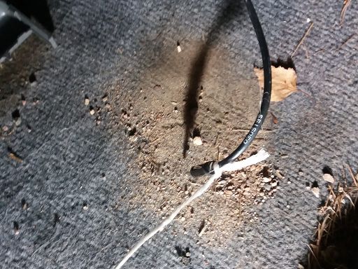

Figure 03 - Preparing a way to be able to install a new antenna cable
  • Next, tie a bit of string round the antenna cable.
  • You can tape a bit of wire to it, but a string is a better solution, as you can tie it securely and its harder to accidentally pull off!

  • As you pull off the cable from the vehicle, make certain that the "service" string which you had attached to it has enough length to remain hanging in the passenger cabin after the entire antenna assembly is removed from the vehicle's roof.
Figure 06 - The moment of happiness when the entire antenna assembly is completely removed
  • Keep going, gently until this (hopefully) happens.
  • I just pulled a bit off the end of a big ball of string.
  • After the entire assembly is removed, disconnect it from the string, but first make certain that one end of the string remains hanging from the roof and the other end hanging in the passenger cabin!

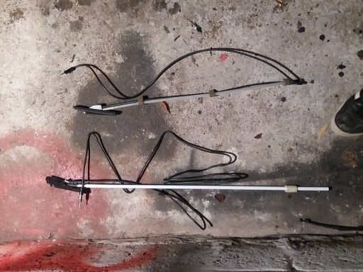

New vs. old antenna comparison
Figure 06 - Old genuine antenna (top) vs. new aftermarket antenna (bottom)
  • Anyway, my aerial (white, on the bottom) is from Ebay (about £20).
  • Its lead is much longer which makes it easier to refit.

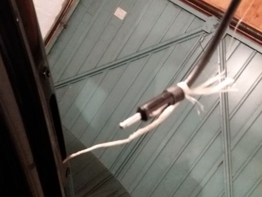

  • Securely tie the roof end of the service string to the radio connector of the new cable.
  • Feed the aerial plug in first through the hole in the roof, gently pulling the string in the passenger cabin back thru.
  • Don't pull too hard - some jiggling may be required.
  • You may need to fish the new plug out the hole in the pillar.
  • Once it's completely thru, bolt it back on.
