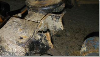

They can wear out in an "oval" fashion that results in a strange "clunk" noise when letting the clutch up.
In the worst case the mount can corrode through and rip away from the axle, this is becoming increasingly common as Jimnys get older.

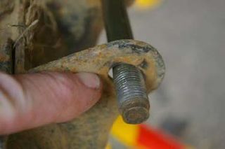

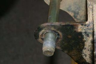

If the holes have worn oval then a welded repair can be carried out by creating some form of repair piece. You could weld strengthening over the hole or, as I do here, create a washer to fix the hole itself. The internet shows a simple steel washer welded over the hole or the creation of a "top hat washer" I had to measure up to make the washers and the picture below shows the finished item and the template I sent to my friendly engineer to make them with. Yes, the template is simply a 2p coin and 2 x 5p coins – they were the correct dimensions for what I needed with a 12mm hole in the middle.

  • The trick is to now open out the oval hole in the mounting bracket to the point where the centre part of the washer fits the hole.
  • I simply filed out the hole until the washers fitted.
  • The first picture shows the washer as it should be fitted, whilst the second picture shows the same washer fitted backwards to show how it fits in the hole.
  • I then filed out the other mount so that the other washer fits.
Washer fitted in place
Washer reversed for clarity of fitting

Washer welded in place
