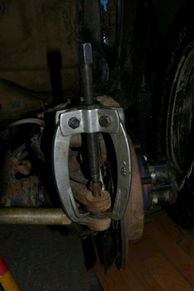

Figure 02 - splitting the joint
  • Once you have confirmed that there is a problem, the task of stripping is actually quite easy.
  • First remove the wheel, it gives you more room.
  • Now use a splitter to break the joint open.
  • Here I am using a puller.
  • I have undone the tie rod end nut but NOT removed it fully.
  • I have put the end of the puller inside the “dish” created by the loose nut on the end of the joint.
  • I then put the puller feet into the gap between the rubber and the control arm that the joint attaches to.

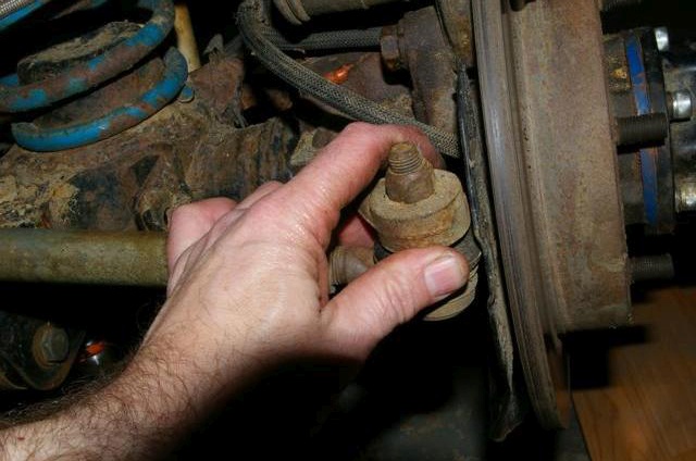

Figure 03 - removing a tie rod end
  • The joint should then split with a bang.
  • Now you have to remove the joint.
  • The trick here is to unscrew the joint without disturbing the locking nut position.
  • The locking nut position is what sets the alignment of the steering.
  • It is best to try and not disturb it too much so that the alignment is not too far out.
  • The joints can rust in and can be very difficult to undo.
  • However, I was lucky and it was possible to wind the joint off the rod without touching the locking nut.
  • Note that in the picture the locking nut appears to be part of the tracking rod itself as it is corroded on.

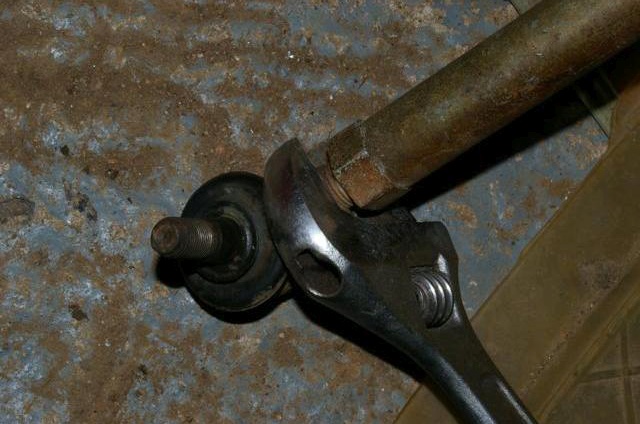

  • The nut is in fact separate and may need undoing half a turn to allow the joint to be unwound.

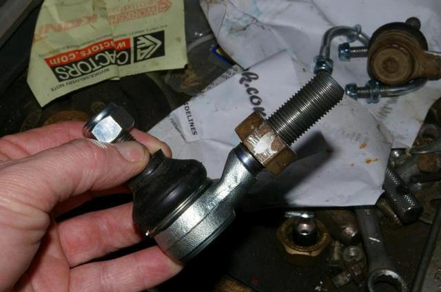

Figure 04 - marking the nut
  • With the tie rod removed, put a mark on the locking nut and then remove the nut, counting the whole turns it takes to come off.

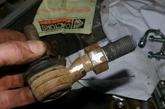

Figure 05 - nut wound onto new joint
  • Now count the same number of turns as you wind the nut onto the new joint.

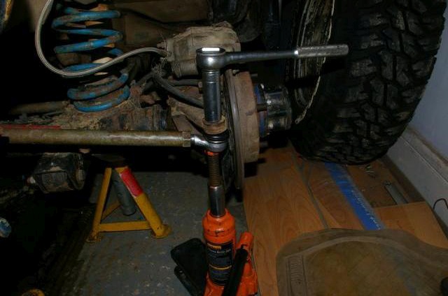

Figure 06 - tightening the joint
  • Wind the whole joint onto the rod and re-assemble.
  • You will probably find that when tightening the top nut on the joint, the whole assembly simply turns.
  • You need to put some pressure on the joint to stop it rotating whilst you are tightening it.
  • Here I have placed a jack underneath the joint and jacked up the joint slightly.
Step 3
Now tighten up the locking nut, replace the wheel and you are finished.
