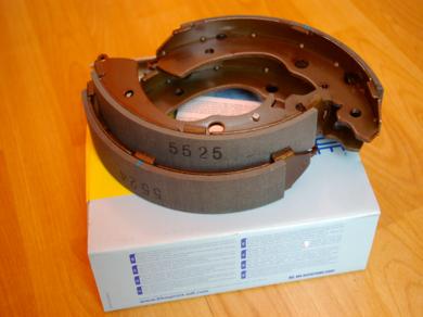

Figure 01 - Rear brake shoes
  • First you will need suitable shoes for your car.
  • The BigJimny store sells suitable shoes.

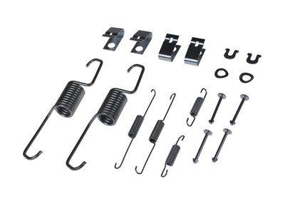

Figure 02 - Brake shoe fitting kit
  • If your drums are particularly old and rusty, you may want to consider replacing the brake mounting hardware.

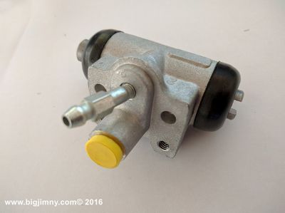

Figure 03 - Rear brake cylinder
  • Although not discussed in this article (why not add it yourself, you can edit this article), the process here covers most of the actions needed to replace the rear brake cylinders if they are damaged or leaking.
  • Again, these are available in the store, Rear Brake Cylinder.

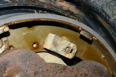

Removing the shoes
Figure 06 - Drum removed
  • With the drum removed the brake shoes can be seen (covered in mud in this case!).
  • Take a really good look at how it comes apart and the position of all the springs and the handbrake adjuster arm as you will need to put it back together correctly later.

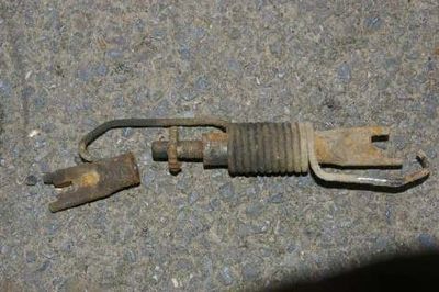

Figure 12 - Adjuster
  • With it all stripped down, everything should be cleaned down.
  • Make sure that the inside of the drum is cleaned out.
  • If necessary, wire brush or emery cloth the surface to clean it up.
  • If a lip has formed around the edge of the drum, then file/grind this down as it makes the drum removal difficult.
  • Take the adjuster mechanism apart.
  • Thoroughly clean the threads and ensure that the threads run really smoothly.
  • I normally use a drop of light oil to keep the threads free of rust along with some small dabs of copper grease on any moving parts.
  • It is worth spending some time making sure the adjuster is clean, otherwise it will not work.

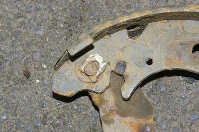

Figure 13 - Handbrake actuator arm
  • The handbrake actuator arm is held onto the shoe by a C-clip and washer.
  • Prise the C-Clip off and remove the actuator from the old shoe.

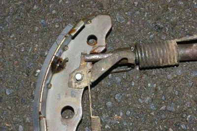

  • Fit the handbrake actuating arm onto the new shoe, re-using the washer and C-Clip.

  • Make sure the adjuster is positioned correctly, particularly the forked end.

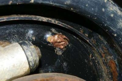

Figure 15 - Greased back plate
  • Now place blobs of copper grease on the shoe contact points on the drum back plate (3 each side).
