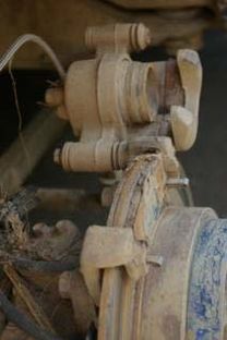

Jimny Front Caliper
  • First of all secure the car.
  • Release the wheel nuts and jack up the car and remove the road wheel.
  • This then reveals the brake caliper, this is the passenger side (nearside) caliper (UK) .

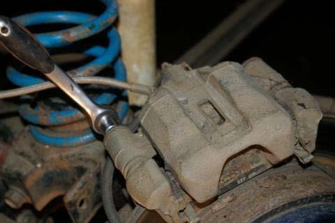

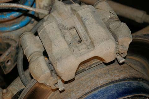

Unbolting the caliper
  • Using a 12mm spanner, release the front caliper bolt (the left is the front of the car in this picture).
  • Then loosen the same bolt on the rear of the caliper.

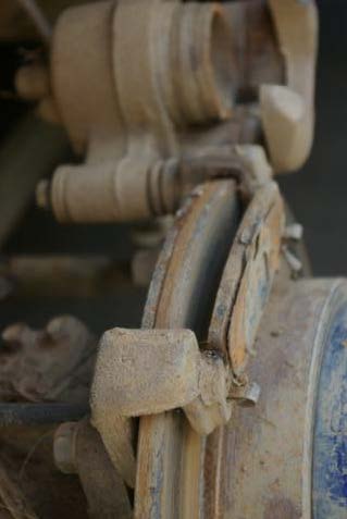

Open brake caliper
  • The caliper then opens up using the rear bolt as a hinge.

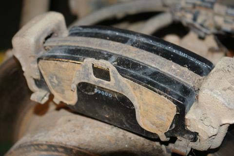

Removing the brake pads
  • The pads are retained by small spring clips.
  • A simple pull on the pads (horizontally away from the disk) should remove them.
  • If the pads resist, gently prise out the pads with a small screwdriver - do not remove the spring clips).

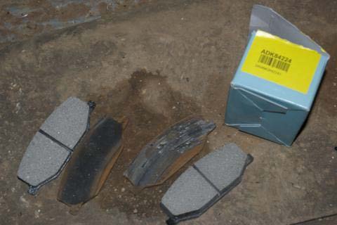

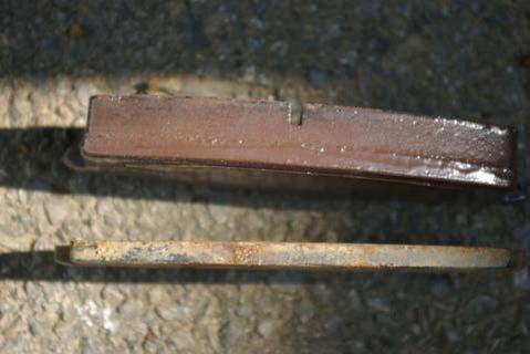

The new pads
  • Here are the new pads compared with the old.
  • Note that ADK84224 are an aftermarket equivalent of the Suzuki part.
  • New pads, are available in the BigJimny Store.
  • The old are worn down to the metal.

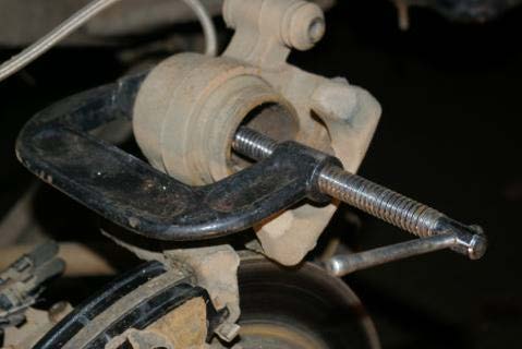

Using a G-Clamp
  • Now the Piston has to be moved back.
  • I use a G-Clamp and wind the piston back in until it is flush.
  • Pay attention to your brake fluid reservoir during compression as this will drive brake fluid back through the lines and can cause your reservoir to overflow.

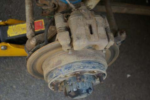

All done
  • Now swing the caliper back into position and bolt up the caliper bolt.
Re-fit the wheel and lower the vehicle.
