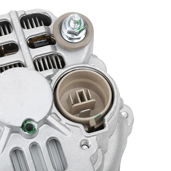

Found this wiring diagram which seems to suggest there are only 2 wires, yours looks like more, but they could just be doubled up.
Wiring Diagram
The larger of the wires go direct to the battery, the smaller I suspect will just go through the ignition warning like, what connections does the new alternator have?
Wiring Diagram

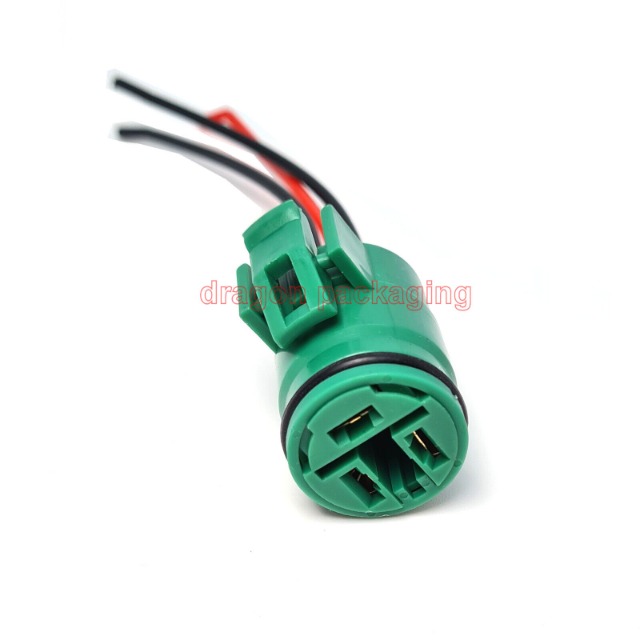

That is a Nippondenso alternator.
The correct waterproof plug is about a million pounds,
e.g. store.alternatorparts.com/c1850-denso-ro...epair-connector.aspx
but you can bodge something with the correct size Lucar clips, or get one out of a Toyota- try and get as much of the loom as you can, it saves buying wire...
Wiring should be
No idea about your current wiring, most likely the warning lamp is white with red trace.
Wiring should be

The samurai usually got the green round denso connector when new.
My older 84 SJ 410 did not have one so when I put the newer alternator in it I just used the std spade connectors.
Was planning to splice in a denso plug, but the spade have not fallen off yet so maybe later.
