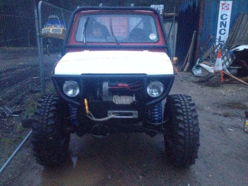

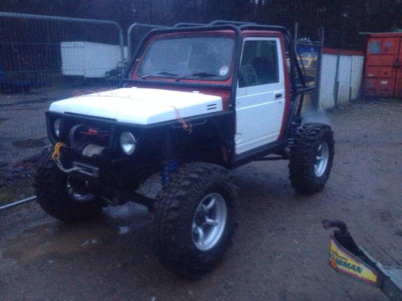

ok well after long deliberation i have decided to say good bye to my jimny
and have bought a pretty much sorted sj based challenge truck
ok the mods hope you have some time
Suzuki sj 413 shell and chassis
Warn 8274 rear with bow motor 11mm dyneema hd contactor (internal wiring)
Warn 8274 front with bow 2 12mm dyneeema gigglepin hd pads and seals Albright contactor (internal wiring)
Vitara power steering set up
Rear mounted batteries
Wrap round fuel cell
Range rover 10 spline front axle
Discovery 24 spline rear axle (welded)
Rock lobster box with hd mounts and cradle
Home made extended trail arms Johnny jointed chassis end rose jointed axle end
2l 8v Vauxhall engine carlton gear box
Extended hoses
Rear mounted rad with electric fans
Custom tunnel
Plastic bucket seats
Plumed fire extinguisher
Landrover 195lb springs
Gwynlewis turrets
Insa turbos 285/75/16
2 led light bars
Cb radio
Harnesses
Dislocation cones
+5 procomp shocks
Chassis stays 80x50 box
Sills 90x90 box
70x50 box cage stays
Fully removable cage
Tubed front wings
Full tray back rear
Chequer plate rear tray
Built in storage box
Bonnet pins
88” wheel base

Is a lick of paint on your list
- geraint
22 Jan 2014 13:47 #101568
by geraint
Replied by geraint on topic comp spec sj project
yes indeed it is haha all comes in time and when its dry lol
doors are only there to stop it getting wet at moment making half doors next weekend
so its only the bonnet thats a different colour

Looking good mate, should be unstoppable!
You can achieve so much more when you don't have to worry about keeping it road legal!
It's no sweat about the wheels mate. The wheels on this are nice!

It needs some mirrors.! I have a pair going cheap.
