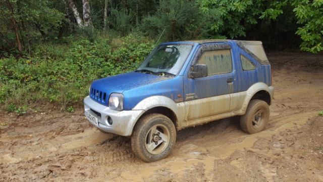

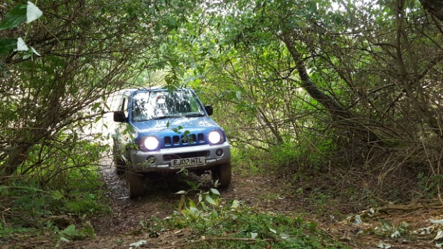

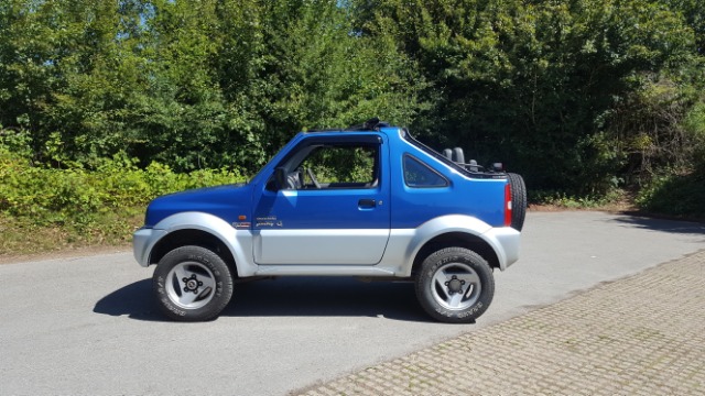

Hey rather than keep just asking questions on here I thought I'd show you my pile.
It's an 02 plate o2 ragtop. Have done a fair few bits so far:
Welded the floor!
2" black raptor lift
Wind deflectors
Manual locking hubs
Uprated headlamps
Wheel spacers
New mid and rear exhaust box
Front pads
Trail Gear HD halfshafts and cv's
Trail Safe uprated swivel seals
Kingpin and wheel bearings
Removed bullbar
Steering wheel
Next I want some mud tyres...it did ok on the AT's but they are its achilles heel. My wife doesn't get it "but it's just had 4 new tyres" but it's like giving a olympic sprinter ice skates they just arent the right footwear!
