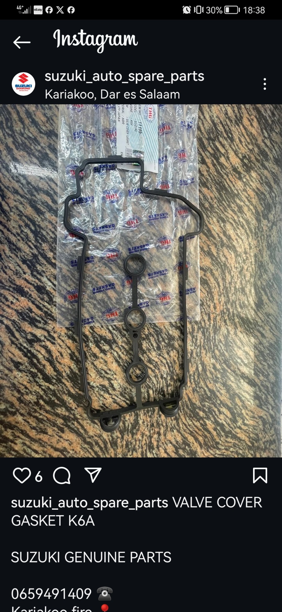

I am having an awful time trying to source a simple rocker cover gasket for an 02Jimny fj 1.3 16v petrol with a K series head. Everyone i search has the typical Erling, Corteco, Stark etc etc and they are all the same which is in fact about 3 inches too long for a K cover. Does anyone have a secret supplier for these. Thanks in advance from a non technical driver

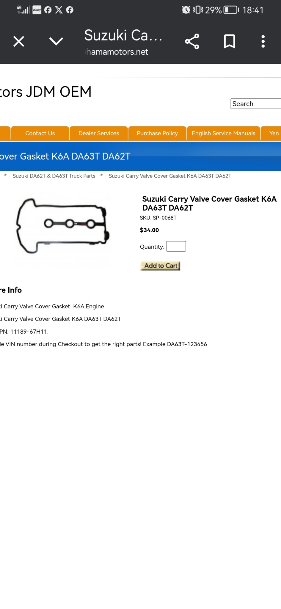

I am in the UK but yes its a Japanese build engine (hence why I understand it's a K) but strangely it has UK plates, doesn't show as an import and on all the parts search engines using the UK reg it come back with it should be a G or an M and rocker gaskets are plentiful ........... so something has either transplanted or improved the head at some point

Jack, i think you sussed it.............looks very much like $34 but i will check in the morning
