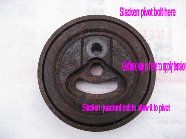

Does the tensioner look like this?
What part pushes in? The middle is bolted solid to the engine....

I may have said it the wrong way round. I must have been pushing the outer ring part, and I could see it moved in and out a little. I guess the middle part didn't move if it's fixed.
