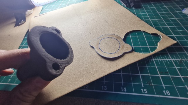

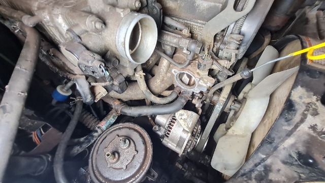

Firstly started with draining the radiator a bit, then off with the top hose. Housing came loose quite easily (I was expecting a bit of a struggle). Once it was off and drained again, I started to give it a clean-up and then templated a gasket on some gasket paper.
I removed and cleaned up the temperature sensor just in case that was reading incorrectly.

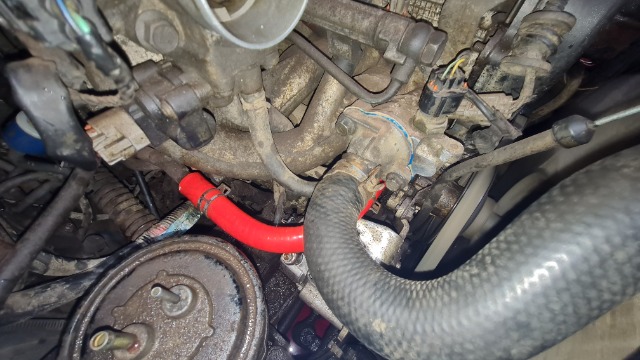

Fitted a new pipe that goes to/from the heater matrix as it looked a bit cruddy. New thermostat in with gasket and a tiny bit of gasket sealant for good measure.
Early signs seem positive with no leaks and I've got heat. But for how long? Who knows. I'll update this thread with the results either way in a week or so. Then I'll see what else is going on and delve a bit deeper (re: Robin's comment).

I've gone with a simple fix for starters with hope that a new inexpensive Suzuki-supplied thermostat will fix it.
