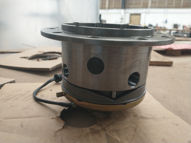

They were well packed and the boxes were undamaged. On opening the packages it's pretty obvious they are Eaton locker clones. They even directly copied the Eaton manual. Overall quality seems not great but usable. Most of the internals are moulded powder metal. I have seen a few people complaining about the use of powder metal parts but the original planet and sun gears in a Suzuki diff are also powder metal, although the moulding quality is better in the Suzuki parts. The switches supplied with the diffs aren't compatible with any of the switch holes in the Jimny so you either have to cut new holes somewhere or find different switches.

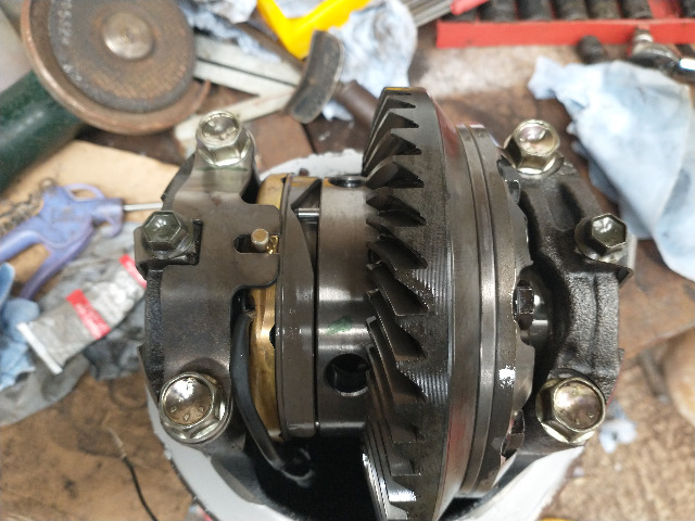

On the 208 the locking plate that stops the solenoid from rotating sits rather high and doesn't catch the locating pin on the solenoid. It can be made to fit with a bit of judicious grinding and filing but in the end I made a new one. Apart from that the installation was pretty straight forward. Just don't do what I did and try to install the ring gear after installing the bearings. You have to remove the solenoid to fit the ring gear and it won't fit past the bearing. The manual clearly states this so I have no one to blame but myself.

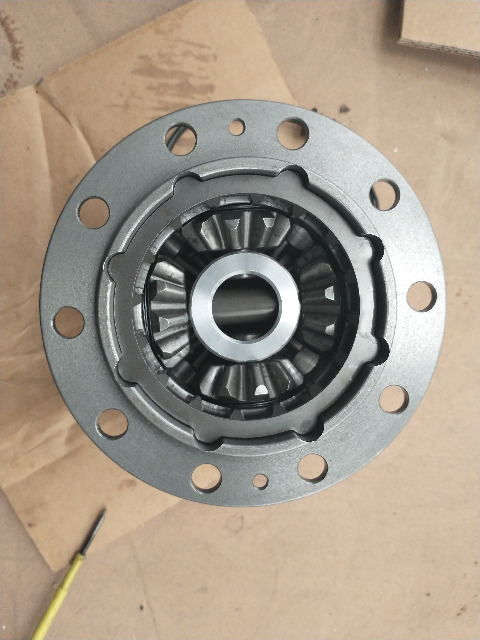

Next came the front ET207 and that's where things started going down hill. I started bolting up the bearing caps and the diff locked up solid. After a bit of investigation I worked out that the pinion was hitting the body of the diff. To figure out exactly where it was fouling I bolted the bearing caps on very lightly and rotated the diff. These are the witness marks left by the pinion.

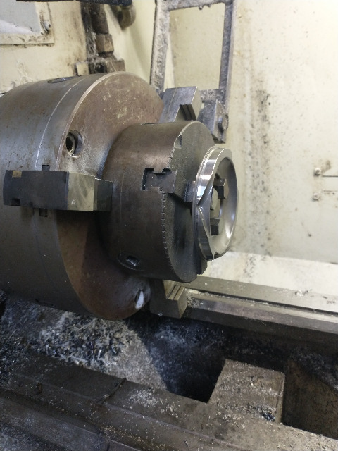

Luckily I have a pretty well equipped workshop so I could modify the diff. It took about 6 tries of disassembling the diff, machining a bit off, refitting, finding where else binds then repeating. I hope I didn't damage the bearing taking it off and pressing it back on that many times.
For future reference I had to machine 1mm off the diameter of the body and grind 0.5mm off of each of the pinion pins. The ramp ring also needed 1mm off most of it's diameter. This allows a clearance of about 0.2mm between the diff carrier and the pinion.
Machining the ramp ring needed some creative fixturing...

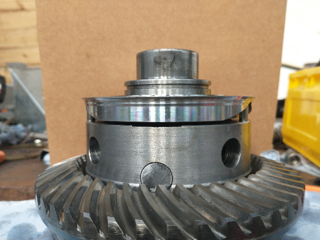

Here's the final result.
At least the solenoid locating bracket is a good fit on this one.
I am in the process of contacting HF about this. It will be interesting to see what they have to say. As they are at the moment I'd definitely not recommend purchasing an ET207 locker unless you have access to a decent sized lathe and are willing to spend a lot of time messing around. The rear locker appears to be worth the money. I'll report back if I have any issues with them in use.

I'm amazed you got marking on the carrier with 0.040" clearance. That's about 1mm. My 0.2mm (0.008") clearance seems far too small then. When I first installed the carrier I had about -0.3mm (-0.012")
