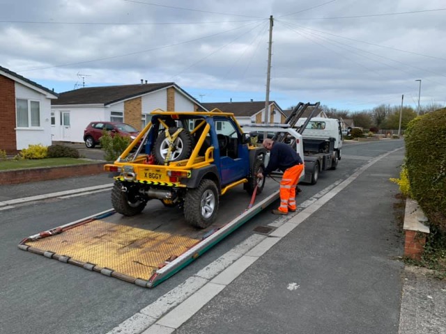

18 Apr 2021 17:02 - 18 Apr 2021 17:07 #234549
Replied by X8GGY on topic HELP! :( The Jimny Boogie won't start... diagnostic video
SUCCESS today!
Started the day under The Boogie with a piece of sandpaper and some pliers... took the spade connector off the starter motor's solenoid, cleaned the male blade connector on the solenoid with the sandpaper, and gave the female side of the spade connector on the end of the wire a couple of squuezes with the pliers until it refitted snuggly onto the blade and would make a better connection...
Started it, stopped it, started it... repeated a good few times, happy with that... so then I rechecked all the jubilee hose clips and found one slightly loose which had caused the loss of coolant water on the last shakedown trip...
I then filled the radiator / system back up with water and left The Boogie running on the drive whilst I made a cup of tea, went back out to find it up to temperature with no leaks... so I finished my tea...
And then drove it round the block, over all the speed ramps...
Back into the drive, turned it off, restarted it, repeat, repeat...
Happy with that, I went for a longer test run, and then... back to the drive, check the cooling system, all good, stopped, started, repeat, repeat...
