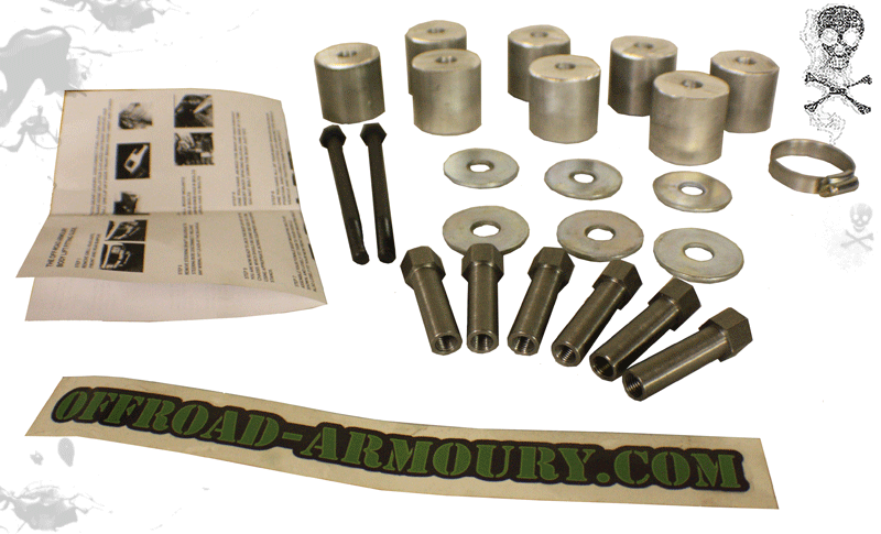

Yes was a way basic kit compared with this, how much is this one, do you know?? Will my kit not fit?? I could probably make those bolts some how and drill my spacers out a bit more..

The kit I've got is just long bolts and two inch spacers this kit looks like it uses the old thread and you just fit the spacers in.. And those long bolts do up from under neithe I guys..

Allen wrote: Yes was a way basic kit compared with this, how much is this one, do you know?? Will my kit not fit?? I could probably make those bolts some how and drill my spacers out a bit more..

As markyp200 suggests, the Ebay kits are really basic and expect you to have an agricultural style tool kit, ie. a very large hammer and a very large drill.
Most of that style of kit expect you to simply drill out the old mount completely (including the old bolt) and then hammer the large bolt they supply right through.
The more expensive kits that have an element of engineering about them provide correctly threaded sleeved bolts or threaded spacers to use the original captive bolts.

Your kit will fit, its just not very pretty in how you install it.
