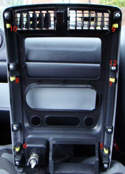

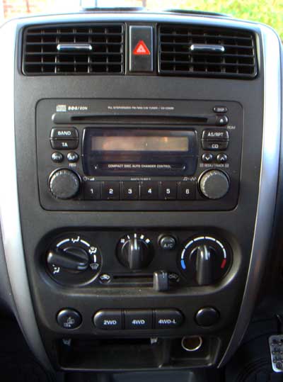

just made up a guide for Suzuki Jimny 2005 on - Centre Console Trim Removal
Firstly pull the ashtray out and remove the cigarette lighter
Next disconnect the power supply to the lighter socket – ref point 1 on the image
The power supply simply “pulls-offâ€ÂÂ
Next, undo the x3 screws holding the ashtray guide and remove
Now, put your hands under the lower trim facia and use your fingers to gently lift the xxx at ref points 2 and 3 (on pic above) whilst at the same time easing the lower trim towards you.
Once these clips are free, simply work your way up the panel gently lifting the facia until it’s free all the way up.
The facia trim should now be free, but you’ll need to disconnect the Hazard Button before you can pull it away.
Simply nip the sides of the block and gently pull it out.
Now we have the trim removed
There are x6 clips (ref points 5 to 10) that need to be removed as they must be fitted to rear of the trim before refitting.
The easiest way to remove them is to turn them sideways then carefully extract.
Here we have the rear of the trim panel with the clips attached, ready for refitting.
These are the clips
I Believe the part ref is: A-pillar: 09409-06324
pdf file download here
[attachment:10]C:\fakepath\dash center panel removal.pdf[/attachment]

the rattle/creak was solved by tightening the fascia retaining screws (only needed 1/8th of a turn to nip them) shown at ref no. 12 in the 2nd last pic
