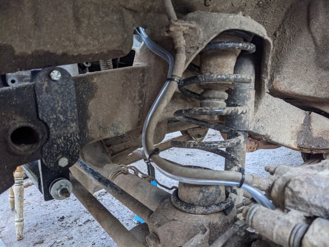

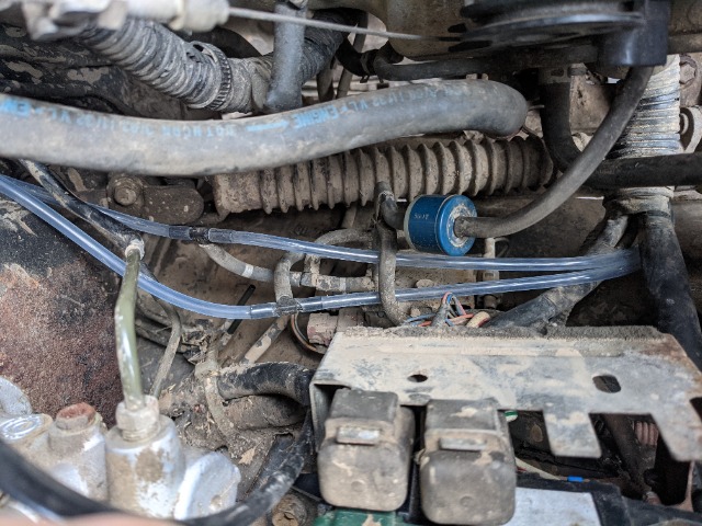

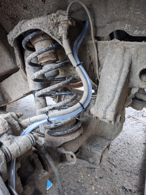

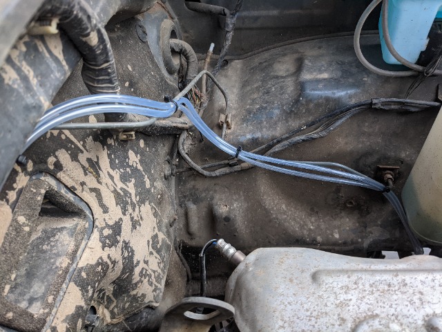

The vacuum lines are a complicated arrangement of steel and flexible pipes and either rust through or become blocked, at which point the front hubs won't engage. It is my understanding that the hubs don't often fail although they can stick.
There are a few options:
1) If the vac hubs are OK, check the vacuum system and if it is the lines replace with new Suzuki parts (expensive) or run new vacuum tubing from the solenoid valves to the hubs. I would put the T-piece at the top and run a separate set of lines to each hub. Flexible vac pipe is not expensive.
2) The alternative is manual hubs, these are about £160, you just take off the old vac hubs and fit them in place. Then block the pipe from the closed/lock solenoid valve to fool the system in to thinking the hubs are locked (or short out the pressure switch) and then the transfer box should work as normal.
I went manual hubs when my vac lines became blocked last Xmas, I have never looked back.
