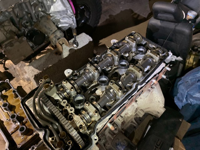

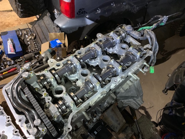

Rare things a clean VVT, but hunt them out. If tis a scrapper you cant run, take the rocker cover off (you will need to for the swap anyway) and have a good look for gooey bunged up oil in the passages, that indicates a lot about the condition of the engine.
as an example of what to look at here are two engines with the rocker cover off (both M series VVT, old one an M13 with at least 100k miles and the new one a M18 but literally brand new)...
New:
Old:
The old one has a lot of oil sludge build up indicating its not had as many oil changes as it should of had, therefore the one to avoid. No engine with miles on will be as clean as a brand new one, but should be better than the old one pictured.
Hope that helps
New:
Old:
Hope that helps
