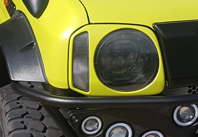

I am not sure what the original poster did to resolve the problem, however parts sales in general to Canada are quite good so some people have managed to get them in,
DOT is an USA/Canadian standard so you are very unlikely to find headlights with DOT certification as the Jimny from 1998 onwards was not sold there. We have "E" marked lights here.
As stated you may have to get inventive. Despite the Jimny headlights being a custom shape, if you look closely at them they are really a round (7"?) core. There are also companies selling 7" round mounting pieces for those people fitting halo style lights, You could fit approved round lights and use the plastic headlamp protectors to fake the original look.
