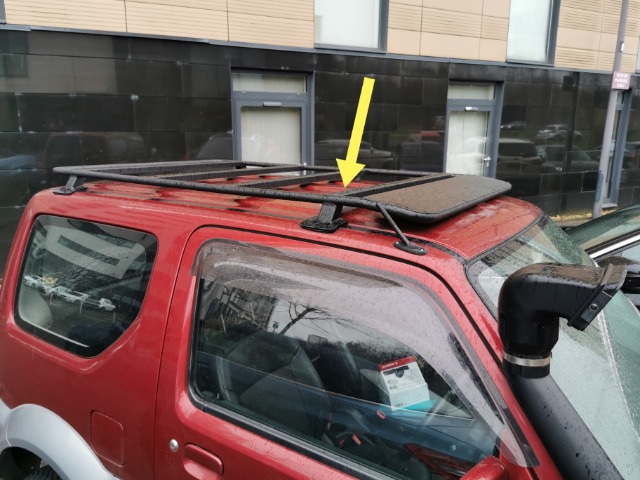

Hi folks,
I have just installed a CB in my Jimny and I am trying to work out the best location for the antenna. I thought I could attach it to my roof rack (yellow arrow) and run the wire through the aerial mount and down the A pillar, but I wasn't sure if I'd get interference from the radio aerial/cable and if the roofrack would be a suitable ground. I have read quite a lot of conflicting information.
EDIT: I have also thought about directly replacing the radio aerial with an antenna, and going without a radio.
Thanks!
Thanks!
Last edit: 04 Mar 2020 11:42 by furo.

04 Mar 2020 15:01 #219376
Replied by DrRobin on topic CB Antenna Placement
The middle of the roof would be best. However, on the roof rack will be fine if there is a good earth. I buy self adhesive copper tape (slug barrier tape), this is very condutive, remove some paint from the roof rack and under the fixings and tape over for a really good earth. Seal it up afterwards with some electrical or self amalgamating tape.
Mag mounts work really well, even though they don't have a direct electrical connection to the roof, they are in close contact to still get the roof working as a good ground plane.

I'd second Gus' solution - it's a long time since I had a CB radio but I had a similar device which worked well.
I've also used mag-mounts very successfuly - my only question would be could a mag-mount get knocked off by tree branches etc - I know the mag moounts are very strong, but could imagine this happening

Mag mounts fall off from branches. So much I do not bother with it anymore. But they work fine otherwise. When installing antenna directly on the roof metal it is best to have 20cm of plane metal around if possible.

Thank you very much for your replies, that is very helpful.
Gus: that looks great, I think I'll get one of those!
One further question: the current aerial doesn't appear to have a ground, will I need to create one? I could connect a wire from the aerial to the bolt that secures the mount to the car (yellow line). Unless that is already built in?
