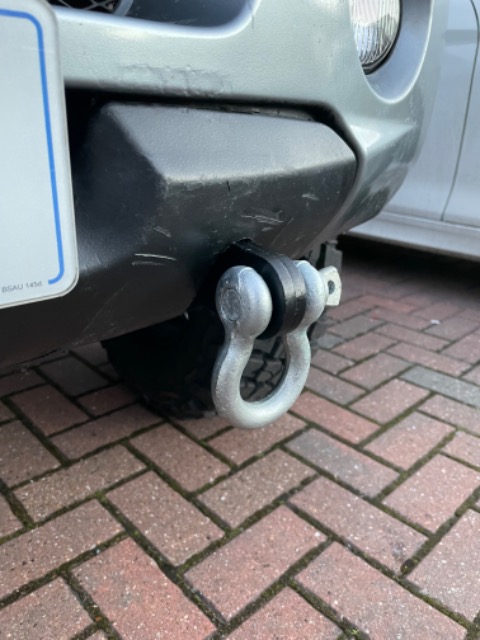

12 Feb 2022 09:55 #241810
by Martin416
SJ416 spi, 33s, Cage, Rocklobster
Replied by Martin416 on topic What did i do to my Jimny today
Looking good I really need to get some decent recovery points up front of mine
