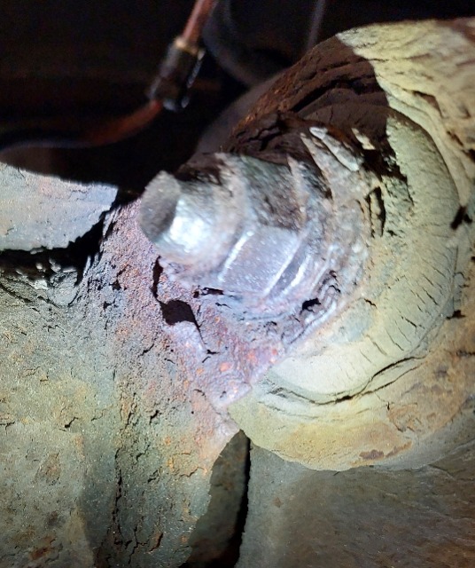

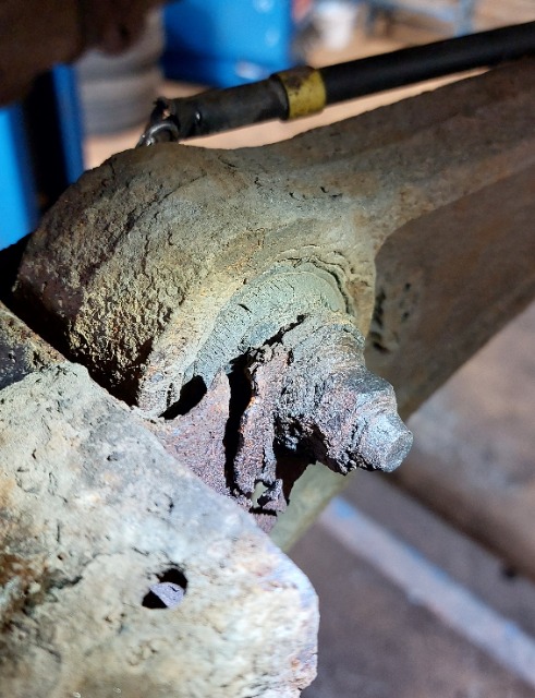

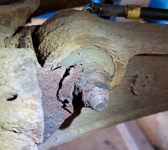

Rear Axle - 2003 Jimny was created by tomcat

It's not a major job to repair that. It's just a case of cutting off the broken bits, making a suitable replacement plate and welding it on. If it's just the one tab that's broken it shouldn't be more that an hour's work, two at the very most.
If you take it to a garage it would probably be quite a bit cheaper to get it repaired than source a replacement axle.

It was a garage that suggested the replacement axle rather than welding!

When I last looked a new axle several years ago was 700 quid just for the tube/casing. I can't see them having got cheaper. I paid about a third of that second hand but it was not really worth the savings over new when the faffing about after was factored in..

Is the rest of the axle badly rusted? If more than just that broken bracket needs repair it may not be economical. If the rest is solid I'd get a second opinion.

My belief is only that bracket is broken but I plan to do a check over the rest to be sure.
