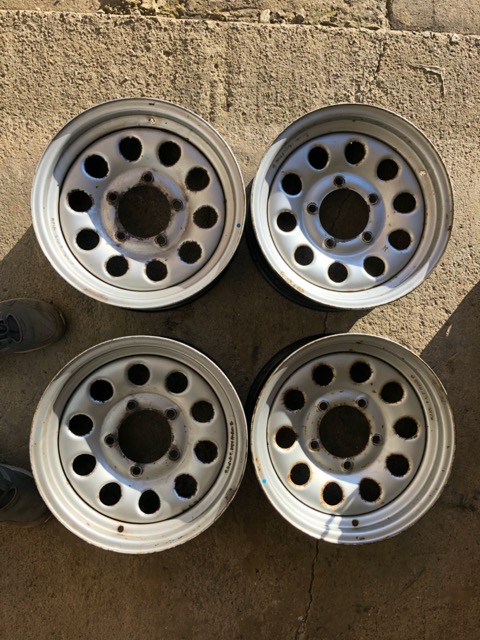

Didn't know Gen 3 wheels fitted the Gen 4 that's a great idea for winter .
04 Jul 2021 21:10 #236402 by lightning
That's a great idea thank you.
If someone has fitted alternative wheels then there's no reason to keep the originals, they are still available to buy new if you or a future owner ever decided to put it back to standard.
05 Jul 2021 07:26 #236407 by DAGZOOK
I'm sure someone will correct me if I'm wrong but the gen.3 steel wheel design is identical to that fitted to the SZ4 & Commercial Gen.4. Size and offset is identical too, ET5 , 15 x 5.5.
I picked my set up for £40! - I had them shot blasted and painted them myself, but if you're after a winter set a simple rub down and coat of paint would tidy them up. If you're interested in what I used, take a look at my build thread.. Soeley has also done a beautiful job to his which can also be seen on his build thread.
