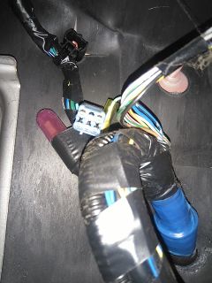

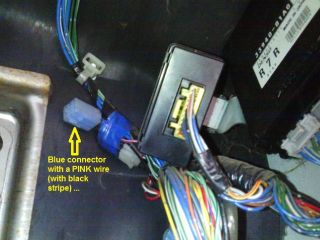

The read-out of the error codes from the ABS computer is achieved by shorting out pins on a small connector located behind the dashboard. It is on the drivers side (both for Right Hand Drive and Left Hand Drive) behind the steering wheel, on the side of the steering wheel nearest the door.
Therefore, on vehicles with the steering wheel on the proper side (RHD) it is behind the dashboard behind the drivers right hand when it is holding the steering wheel.
If you are in one of those Jimnys with the steering wheel on the wrong side (a legacy of being invaded by Napoleon) then it is behind the dashboard behind the drivers left hand when it is holding the steering wheel.
It is a Blue colour connector with a PINK wire (with black stripe) and a Black wire and SIX connector positions but only two in use.

  3. Using a piece of wire, short the two pins in the connector together.
    • Variation: Early models (with G13BB engine) require you to remove the ABS diode (pull it out) at this point, this is not shown in the picture (does anyone have a picture of the diode??)
