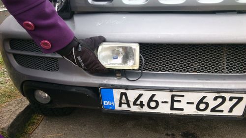

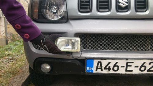

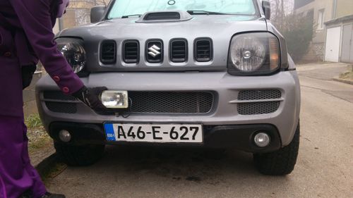

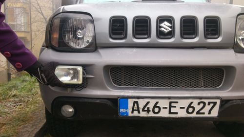

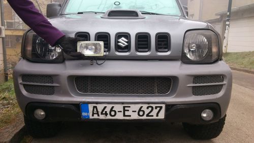

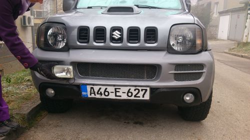

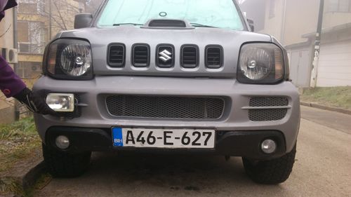

Inside the bumper
In the case of the front bumper both on Jimny 3 and 4, it is not advisable to mount anything in the center bumper hole where there is a factory ventilation grille (except for very small lamps), because that might severely restrict the air flow towards the engine heat exchanger (improperly called "radiator").
In the case of DDiS Jimny 3 with 63 kW K9K 266 diesel engine (2006-2010), it is also not advisable to mount anything in side ventilation grille holes in the front bumper, because that will restrict the air flow towards the intercooler which is positioned just behind the right side ventilation grille in the bumper.
In the case of a petrol Jimny 3 with 2nd gen. front bumper (2006-2012), installation of additional lamps in side ventilation grille holes in the front bumper should not incur significantly negative effects regarding proper engine cooling (apart from possibly looking ugly), it is a viable option.

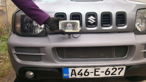

One simple solution (in theory) is to simply drill two holes on the top of the bumper (in front of the hood) and mount the driving lamps on the bumper itself. However, as the bumper is made of thin plastic, it vibrates and wobbles during driving, and so will the lamps that it would carry. Unless you fancy looking at the "dancing lights" in front of your vehicle while driving, you might quickly get sick of that annoyance in your field of vision.
The vibration issue can be remedied by one of two methods:
  1. Reinforce the top of the bumper (from the inside) so that it becomes thicker / stronger / stiffer and does not vibrate and wobble. This is typically done by applying one or two layes of special plastic net soaked into thick epoxy resin (that's what vehicle bodywork restorers do when they fix damaged plastic vehicle panels). However, this solution might not entirely fix the vibration issue, depending on the weight of the driving lamps.
  2. Fabricate and install / weld your own metal mounts behind the front bumper, which would hold onto the chassis. The mounts should end right below the top of the bumper. Then drill two holes in the top of the bumper just above the mounts. This will enable the driving lamps to be screwed into the mounts, and the bumper will have no weight bearing function whatsoever. This solution has been proven as a stable platform in practice, and completely eliminates the vibration / wobble issue. However, any future removal of the front bumper requires prior removal of the driving lamps.
  3. Buy ready-made or fabricate your own metal L-mounts which attach to the slam panel behind the bonnet grille and hover above the front bumper. Then attach the lamps to those mounts.
