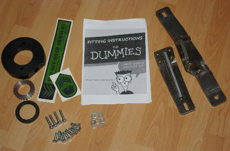

Figure 01 - ORA kit
  • First you have to get ORA kit.
  • This picture shows the kit as shipped.
  • In the kit you get the speedo adaptor, the mounts and bolts and washers to assemble it all.
  • Not shown in this picture are the replacement mounts which are included in the kit but came separately in my early version.

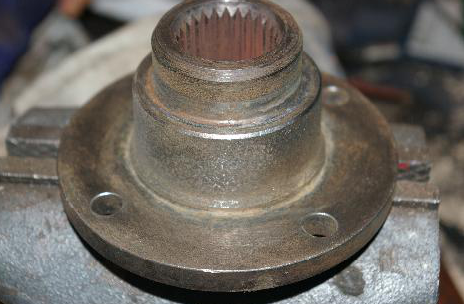

Figure 07 - oil seal fitted
  • Now you need to clean up the stem of the flange.
  • The oil seal is going to fit over this and ideally the oil seal should sit on a machined surface.
  • The flange is rough cast and does not make a good oil seal surface.
  • You should clean it up the best you can to smooth the surface as much as possible.
  • Then push the oil seal onto the flange as shown in this picture.

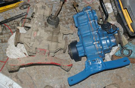

Figure 11 - finished SJ case alongside the old Jimny case
  • You should now end up with this.

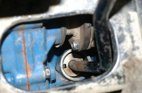

Figure 13 - un-modified lever
  • Now you need to fit the transfer lever.
  • As you can see from this picture, the position of the SJ transfer box means that, un-modified, the lever is jammed against the transmission tunnel.
    • Note that this is with the lever in the fully “back” position – it needs to shift forward from here!

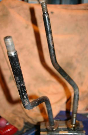

Figure 14 - lever bent into position
  • However I did find someone eventually.
  • The lever needs to be rotated and bent back.
  • Here is the finished item, in exactly the same ratio (4WD High) as in the previous picture.

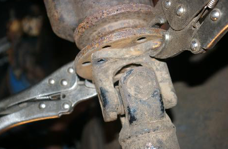

Figure 16 - flange clamped for drilling
  • So now we are on the home run.
  • You need to replace the rubber boots on the lever and bolt up the propeller shafts.
  • In my case I could only get the medium size SJ flanges and prop.
  • Therefore I needed to drill the rear diff flange to take the prop.
  • This involved clamping the prop to the flange and drilling through.
