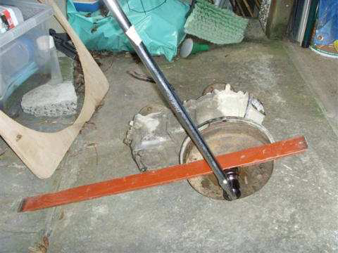

Figure 02 - flange removal bar
Figure 03 - Andy's picture of the bar in action
  • Now remove the drum (on drum brake versions) and flanges.
  • The flanges are retained by a 27mm nut that is locked on two sides by being bent into grooves in the shaft.
  • I have found the best way to remove these nuts is to grind away with a Dremel the bent locking part and then bolt a long metal bar to the flange.
  • You can then use a 27mm socket on the nut and use the long metal bar to prevent the flange from rotating.

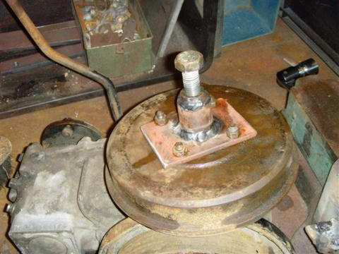

Figure 04 - Andy's drum puller
  • The Drum Brake also needs removing.
  • This can be difficult.
  • I found that by completely undoing the nuts on the adjuster mechanism on the rear that the brake mechanism fell apart and the drum could be easily removed with a slide hammer.
  • Andy also had problems with his and he created a puller from some metal plate and a bolt.

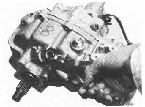

Figure 05 - removing the speedo drive
  • Now remove the speedometer driven gear.
  • This is the mount where the speedo cable was attached.
  • Make sure the little 10 mm bolt is fully removed.
  • You may be lucky and be able to pull out the gear with mole grips.
  • But it may have corroded into place in which case you are in trouble.
  • I found that by grinding (with the Dremel) a small groove in the top of the gear and then insert a small chisel in the groove and gently hit the gear attempting to rotate it and break the corrosion.
  • This picture is not clear, the transfer case is upside down, the speedo drive is just below the painted number 8 on the picture.

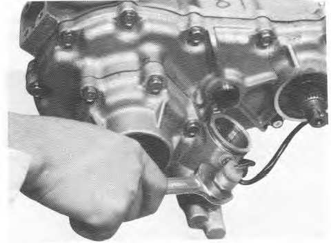

Figure 06 - removing the 4WD switch
  • Now remove the 4wd switch.
  • This has a small ball bearing inside - do not loose this!

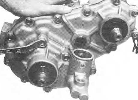

Figure 07 - removing the front of the transfer case
  • Now take off the front section of the transfer case.

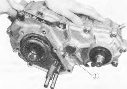

Figure 08 - splitting the case
  • Now undo the bolts that hold the centre and rear cases together.
  • Do not undo the bolt marked "1" in the picture.
  • When you split the cases, be careful of the shims that will fall off the shafts.
  • Make a note of where the shims came from.

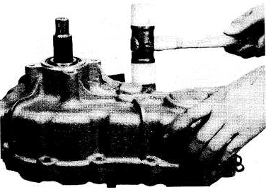

Figure 18 - driving out the shaft
  • The front case bearing is more hidden.
  • You need to pull out the oil seal and remove the large circlip inside.
  • Using a soft mallet you can then drive out the shaft.
  • It will then be possible to drive the old bearing out from behind.

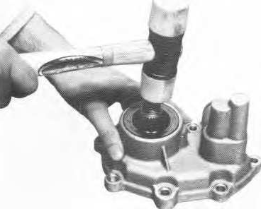

Figure 19 - front case bearing
  • Putting the new bearing in requires some care.
  • I used a metal plate behind the case and put a bolt through with some large washers and tightened the bolt, pulling the bearing into position.
  • At this point, with all the bearings changed, you can fit new oil seals if required.

  • Squirt some gearbox oil over the bearings and moving parts to help everything when it spins up for the first time.
  • The cases should then push together with a firm push.
  • Bolt on the front case section.
  • Reinsert the 4WD switch and ball bearing.
Figure 24 - welding up the speedo drive
  • If you are building the Transfer Case for an SJ you will need to reinsert the speedometer drive at this point.
  • If you are building it for a Jimny, then you will have no need for the mechanical drive.
  • However you will need to put something in to stop it leaking oil.
  • I simply took the SJ speedo mount and welded up the end and silicon gasket sealed it into place.
  • The left picture shows the starting point and the right picture shows my blob welding part way through (I cleaned it up with an angle grinder so I could spot the holes).
