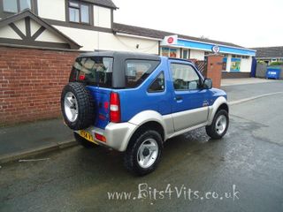

Soft-top ("cabrio") specifics
- The Soft-top edition retained the G13B engines until the end with some late first-time registrations in 2005.
- There are some M13A engined soft-tops around but these seem to be rare and an anomaly.
- The soft-top frames suffer considerable corrosion at the front.
- Suzuki no longer makes these parts and getting hold of replacements is extremely difficult.
- New soft tops can be bought from Monsoon in the UK.
- They have a reputation for good quality.
- There is a removable hard-top available to replace a soft-top during winter.
- Contact the BigJimny Store as some are still available.
- Dave at Bits4Vits has an article on fitting one.
